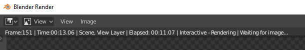

When rendering an Animation Octane is not rendering and shows "Waiting for Image …"
Rendering a single frame runs fine. What is running wrong?

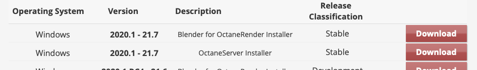

Today I installed this Blender for Octane Installer and this OctaneServer Installer, both 2020.1 - 21.7:

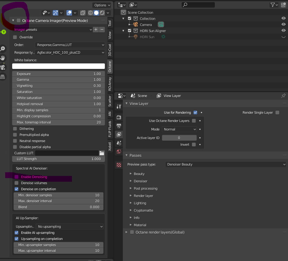

Sorry if I’m not addressing your specific issue. Final F12 rendering seems to work fine. But looking at your file I see why the preview is not rendering in the viewport and why it says “waiting for image.” The preview isn’t rendering because in View Layers Properties tab you have the preview pass type set to Denoised Beauty. However, the "Octane Camera Imager (preview mode)" is not activated. You need to both activate the preview imager AND you must select Enable Denoising.
Or you could just change Preview pass type to Combined, in which case you don’t need to activate Camera Preview Imager at all to see the rendering in viewport.
