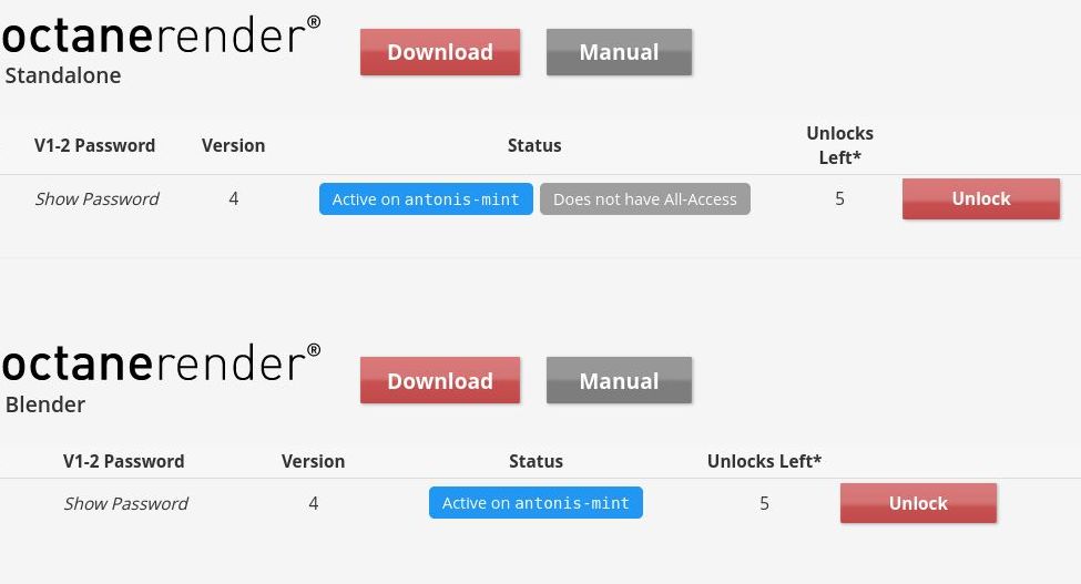

5. tried step 3 again... it seems my license was locked (to my current system!) so I had to use one of my unlocks... still no luck.

I am already under support from someone from OTOY since I also issued a ticket.
However I first used that version that you mentioned and for reasons I can't understand I am not entitled to use that version. I have a version 4 version lisence for standalone and blender.

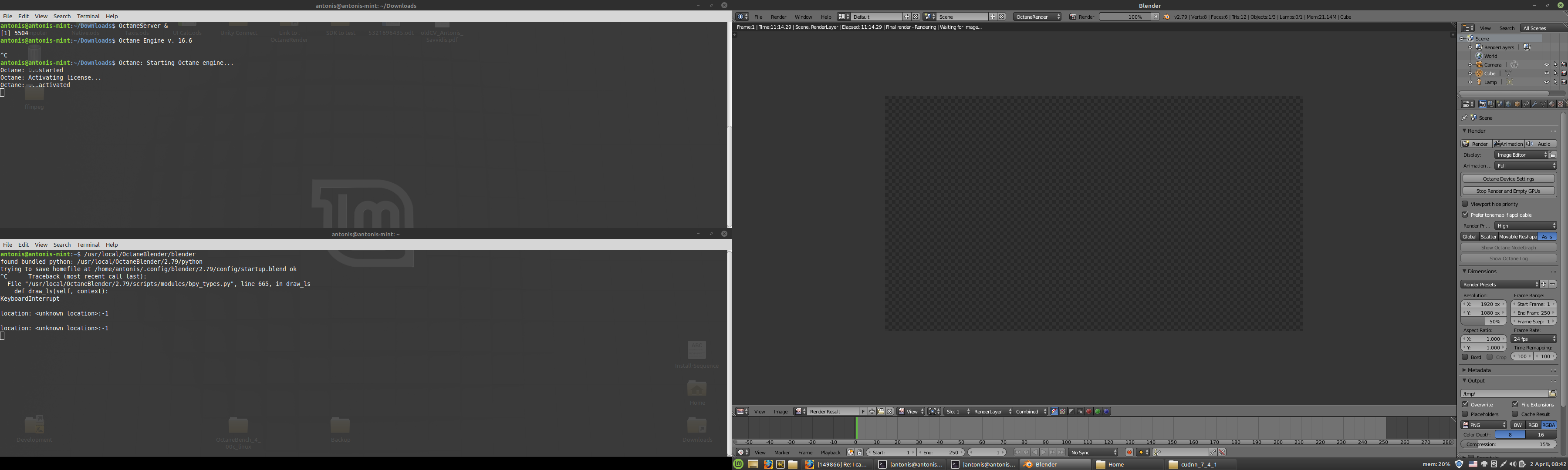

My Octane server terminal goes:
Octane: Starting Octane engine...
Octane: ...started
Octane: Activating license...
Octane: ...activated
and my blender is stack like this:
