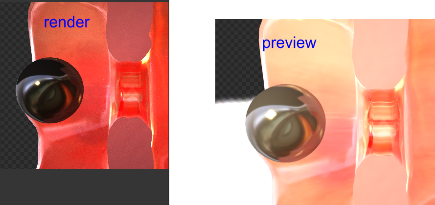

Hi Everybody,
Was working away, and must have clicked something inadvertently, but can't figure out what.
Now preview is correct, but render is off.
Color management is set to "none".
I can rebuild the file, but maybe this is something obvious? Would love to know how to avoid.
What in the heck did I do?
Thanks for any help,
Rick

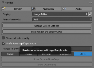

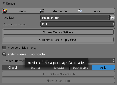

Hi Rick,
you have disabled Tone Mapping for final render in render settings "Prefer tonemap if applicable" If you enable this option you final render will match preview render.
