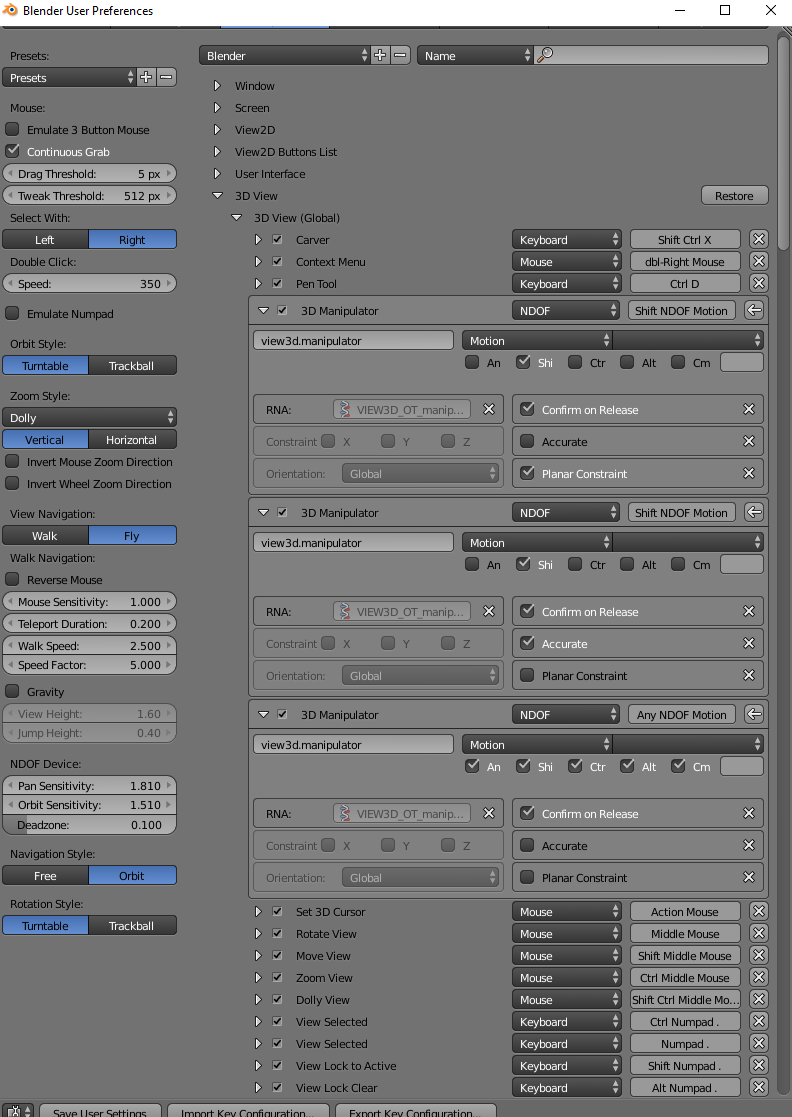

EDIT: SpaceNavigator *does* move if I press SHIFT while using the device. So I probably need to change a setting so that the device no longer needs SHIFT.
However, if I go to Blender/Preferences/Input/ED View/Move View/NDOF and remove the tick from SHIFT, the SpaceNavigator almost stops working and the only way to make it work again is pressing 'Restore.'

In my version, I can only move side-to-side and up/down if I press SHIFT while moving the SpaceNavigator. So it would make sense to remove the tick from SHIFT in the NDOF settings shown in the attached image. But that doesn't make any difference.
I've tried all settings, including the ones that worked in Blender 2.76, but nothing works...
I've also installed all non-Octane versions between 2.78 and 2.79 and none of them work. 2.8 works, though.

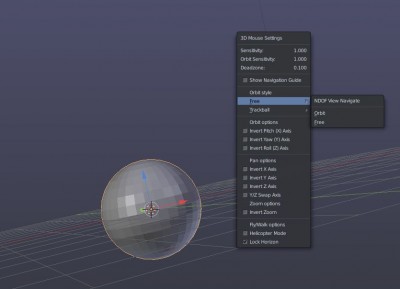

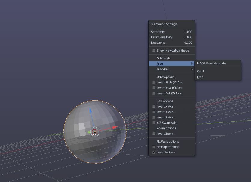

Try changing the options in the menu that opens when you press the Left button on the 3D Connection.
For maximum freedom you should set the Orbit Style to Free and Trackball. I hope it helps!

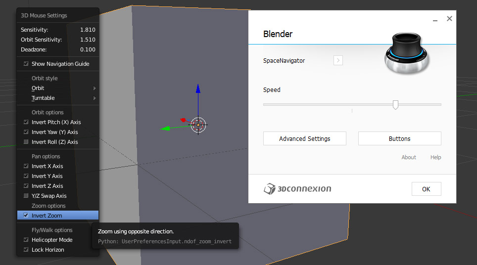

Thank you for your reply!linograndiotoy wrote:Try changing the options in the menu that opens when you press the Left button on the 3D Connection.
I think this depends entirely on what the user wants ...
I can understand that this setting works for you, so that's great -- but if I were to choose that, I'd be totally dizzy
The settings that work for me (except pan/tilt in 2.78-2.79) are those I posted earlier in this thread.
