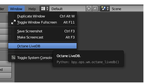

Octane for Blender now supports Live and local DB feature from OctaneRender™ for Blender 4.02.1 - 16.3.3 [STABLE] and OctaneRender™ for Blender 2018.1 RC4 - 17.4 [TEST]. Also, feel free to test the Orbx import feature in Octane for Blender 2018.1 RC4 - 17.4 .
Go to Windows menu> Octane LiveDB to access the new Live and Local DB.

I have installed Blender_Octane_Edition_4.02.1_16.3.3stable, and I have located the C:\Users\Your_User_Name\AppData\Roaming\OctaneRender\localDb file, however,
The windows menu shows no sign of Octane LiveDB .

Hello protovu,
The liveDB entry is put in "Window-Octane LiveDB".
About the orbx import feature, it is also available for OctaneBlender now. You can find it in "Properties-Data-Orbx properties-Orbx File Path" in OctaneBlender after 17.4.
