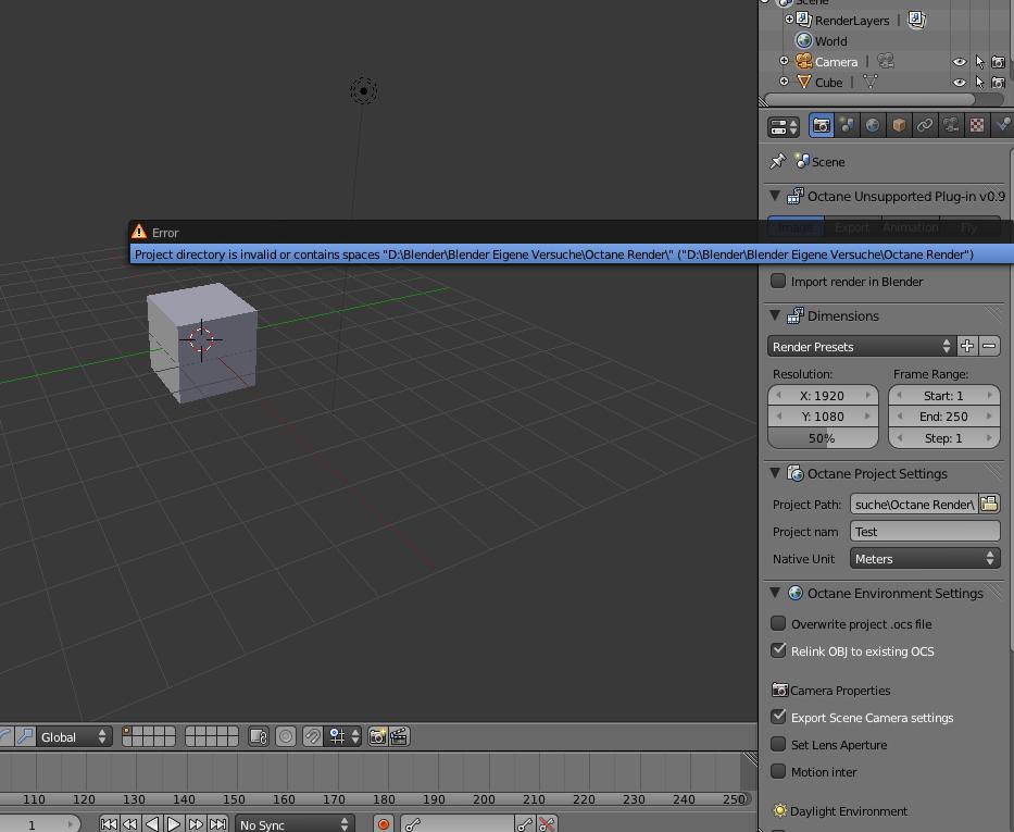

Hey guys, i can't figure it out to get it work. I followed Jonathans tutorial but i always get the same message
"Project Directory is invalid or contains spaces"
i tried both, with and without relative paths but i always get the same message.
I use the current 2.56 from blender.org, Octane 2.3 V5 and the latest exporter version 0.93
Always the same problem "Project directory ....."

Maybe you should try to use a directory without spaces?
"Blender Eigene Versuche" contains spaces.

yeh i have to admit for ages I kept on forgetting that 'F:\My Documents' had spaces in it eheh

why dont you try 2.43- which is the latest (not 2.3 V5)
cheersliquid orange wrote:I use the current 2.56 from blender.org, Octane 2.3 V5 and the latest exporter version 0.93

Thank you guys, it works right now. I totally forgot that "My Documents" also contains spaces. I also downloaded the current version 2.43.
