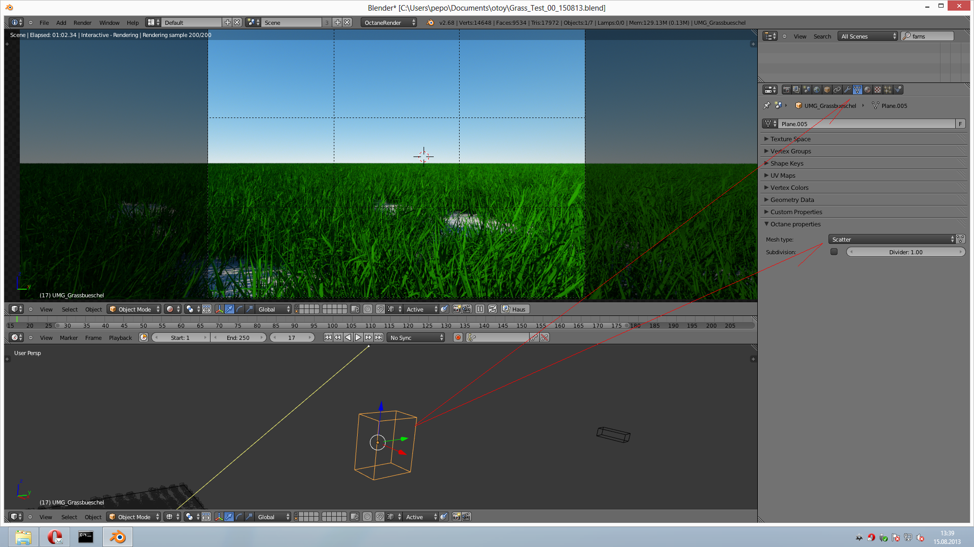

Here is the File with the grass (grasspatch is from Gabich):
http://www.pasteall.org/blend/23427
With Cycles I can set the amount of Particles up to 100000 without problems.
During the rendering process it takes only about 4GB RAM (not VRAM).
With Octane for Blender I can only set an amount of Particle up to 1000, if I set it higher then Blender crashes during the transfering process.
During the rendering process (set to 1000 Particles) it takes 10GB of RAM (not VRAM).

mib2berlin
Posts: 1194
Joined: Wed Jan 27, 2010 7:18 pm
Location: Germany
Hi Alain, change particle objects to scatter.
Srceenshot rendered with 100000 particles.
Cheers, mib.

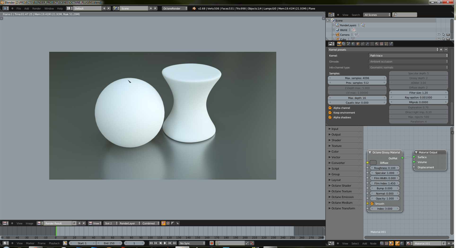

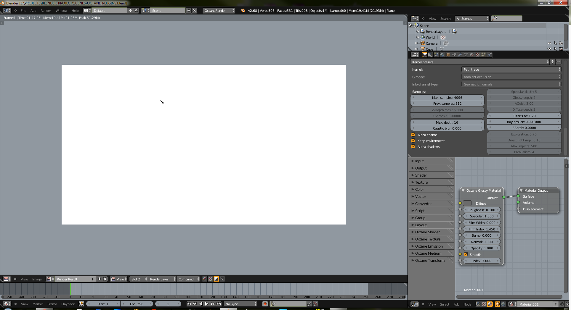

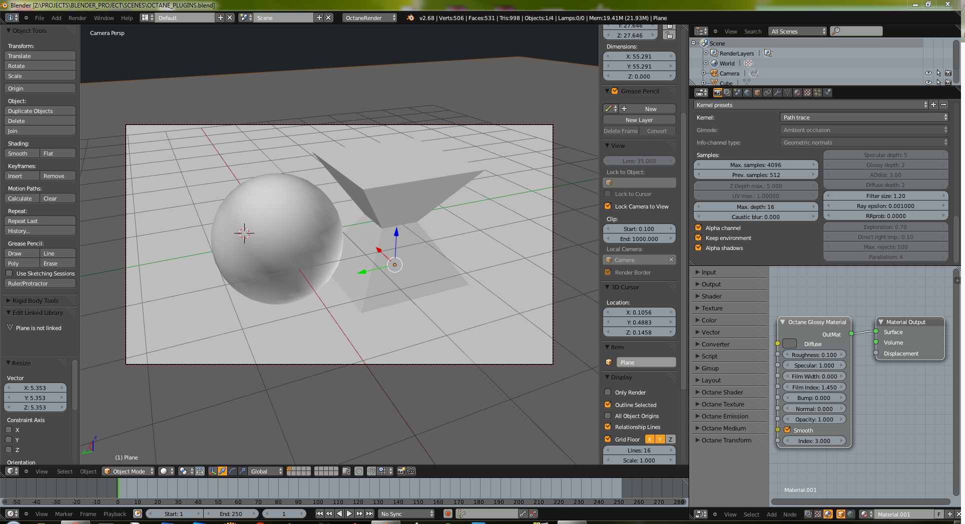

Hi all,
Found a little bug (or not). When I use subdivision surface, I uncountered black patches / triangles into the surfaces. It's make an alpha hole (cf. screenshots).
Matt
