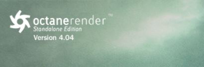

I'm using OctaneRender_4_05_win and OctaneRender_for_SketchUp_2018_4_00_0_20_win (even if it incorrectly reports version 4.04 on splashscreen).
but when I start the render from SU it starts version 4.00.
It doesn't seem to communicate with the standalone 4.05 installed
