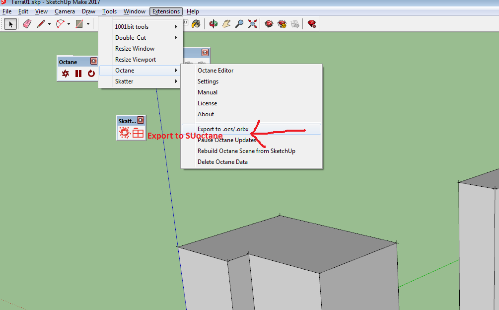

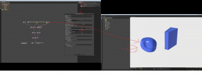

When I export ocs > settings for subD etc. are available.
Why not make this the default??? If it's a problem whit modifying components/groups inside SU > then make a lock/unlock button in plug-in interface.
> When it's locked the obj are exported to assets folder.
> When unlocked ....function as it is today.

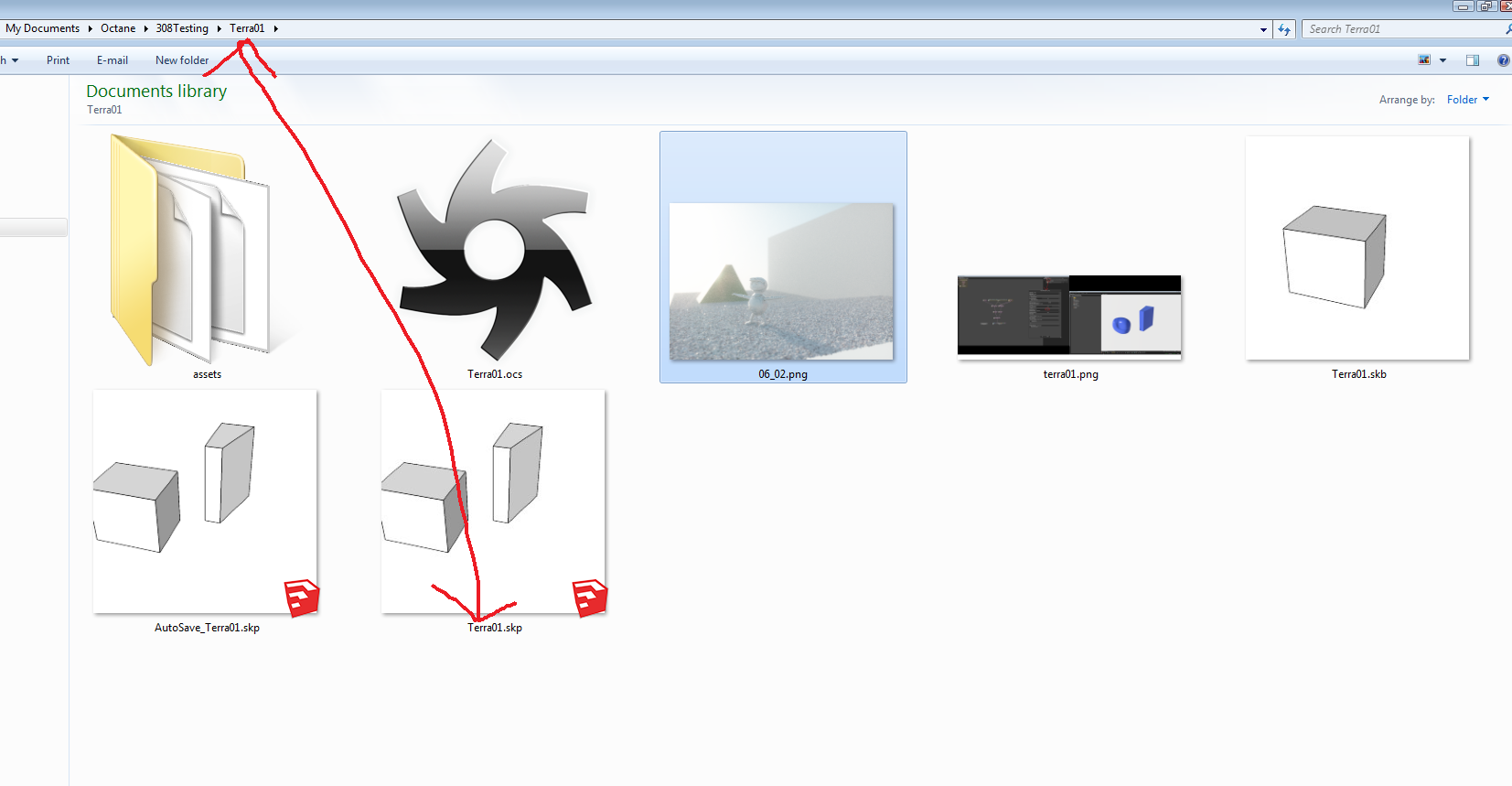

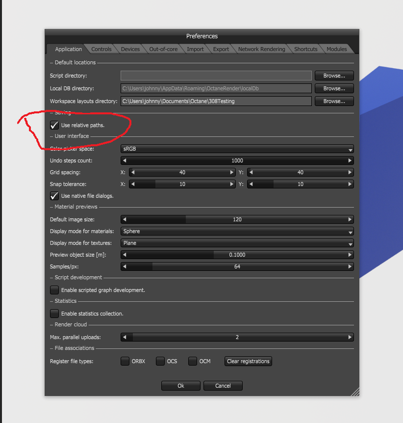

When I export ocs every assets get exported to same folder. Please make folder name that reflects the SU filename.
Today I put every SU document inside it's own folder and this is not ideal. If i don't do this the asset folder becomes a complete mess.
NB: If this is a lot of work don't prioritize it ......but it can be seen in relation to a bigger file structure discussion.
Default file structure workings MUST!!!!!!!!!! be as standalone. If I want to travel whit my Octane/SU project we can use the "Use relative paths" in existing UI.
In addition please make an "export SUoctane" that copy every octane material texture to "filename"assets folder+SU file with modified image links to the same folder. Now zip the folder and you are god to go......
AND it's not user friendly to juggle between two texture structures :evil:

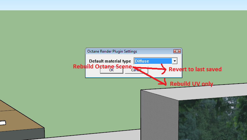

Pleeees Cap :) make the "Rebuild Octane Scene" button only rebuild/update the UV mappings (alternatively make it customizable). I very seldom want to destroy every octane materials, lighting and kernel setup etc.
but would very much like to use UV mapping tools like ThruPaint.

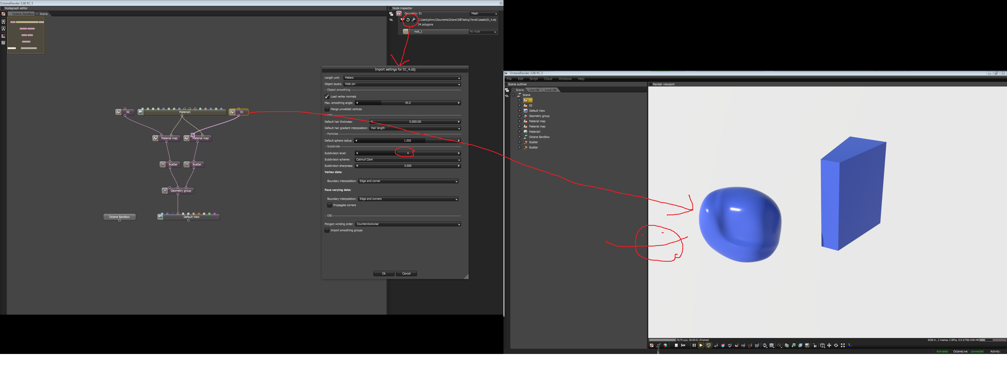

Suggestion for "Rebuild Octane Scene" button.
