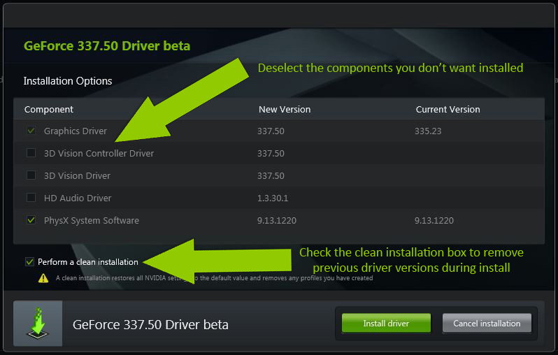

Please, try to downgrade the drivers to 382.33, performing a clean installation:

i tried a clean install of the recommended driver - but the problem still exists :-(
