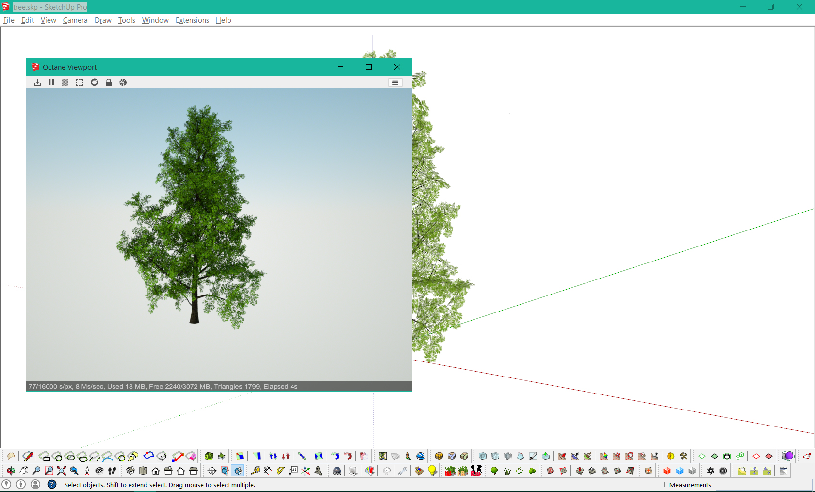

I will, I'm just waiting on a windows 10 update for fraps. I probably should explain better what's happening...
v0.14 - v0.151...
- I have a tree model that I want to use as a proxy.
- I open the render window, press export to ocx/ocr.
- The render window shows a zoomed in part of the tree.
- On the SketchUp window I move the scene around and the octane viewport then follows my cursor movements.
- I then set the proxy to an object in a new document.
- In the render viewport, nothing renders where the proxies are supposed to be.
Thanks for paying attention. Hoping to see great things as time goes on.
For now I can bypass these steps with .15. and use .13 with SU2014.

fivebythree, which specific older version of the plugin are you using that works for you? 0.13.what?

CaptainCrowbar wrote:fivebythree, which specific older version of the plugin are you using that works for you? 0.13.what?
v0.13.82
Will there be any sort of update regarding object scatter data within the SketchUp plugin? I use Phantom Scatter for time being, with Octane Standalone. But not having to leave the SU environment would be ideal.
Forgot about this clip I made. It basically outlines the same troubles as listed above.
https://youtu.be/Ijoja_MuMdc
