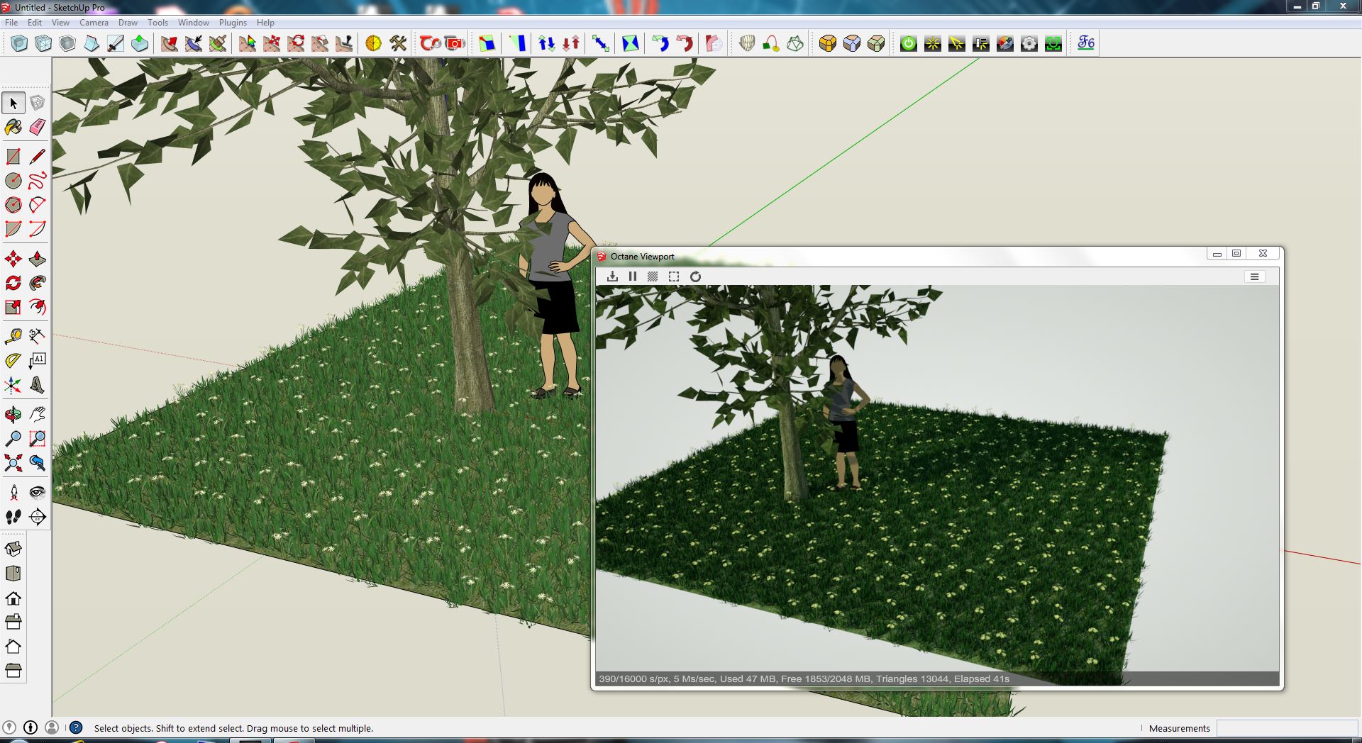

Congrats to the octane team for this SU Plugin.
Build a quick tree on grass to test.
Did not export anything, just clicked on render, and it work.
1st test show that geometry transfer used the component def of SU, so this image was created by Octane almost instantly, even with grass.
They made what I dreamed of since the first version of Octane.
Thks again!!!!

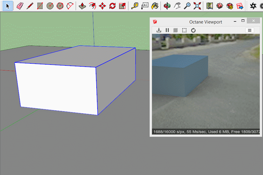

Hi mate!
Good to hear you liked the feature :)
As for the scaling, that's strange. Proxy should reflect all the changes that you make to the Sketchup component. Check the attachment.
How do you create the proxy? It might be that you are scaling different component (that is nested inside the component that is actually connected to .obj file in Octane)
