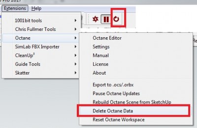

Rebuild Octane Scene and Delete Octane Data is the same function? Should this button really be on the toolbar, since it erases all work done to materials and settings?

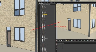

The Texture bug is still there. I am using Sketchup 2017.
Download the sample file here: https://sprend.com/download.htm?C=bb0cb ... c65d2434d3
(I cannot try in Sketchup 2018 since the sketchup license system does not allow you to use 2017 and 2018 at the same time, and we are using Octane 3.04.4.5 in production, and that version is only available in 2017.)

Can the developer confirm the "texture" bug? Or anyone?
patrickbarnekow wrote:The Texture bug is still there. I am using Sketchup 2017.
Hi Patrick,
Thank you for the feedback.
It seems there is a mesh overlapped on top of the brick wall.
Could you please share the file again or through PM for us to debug? The link says it's expired.
Cheers
