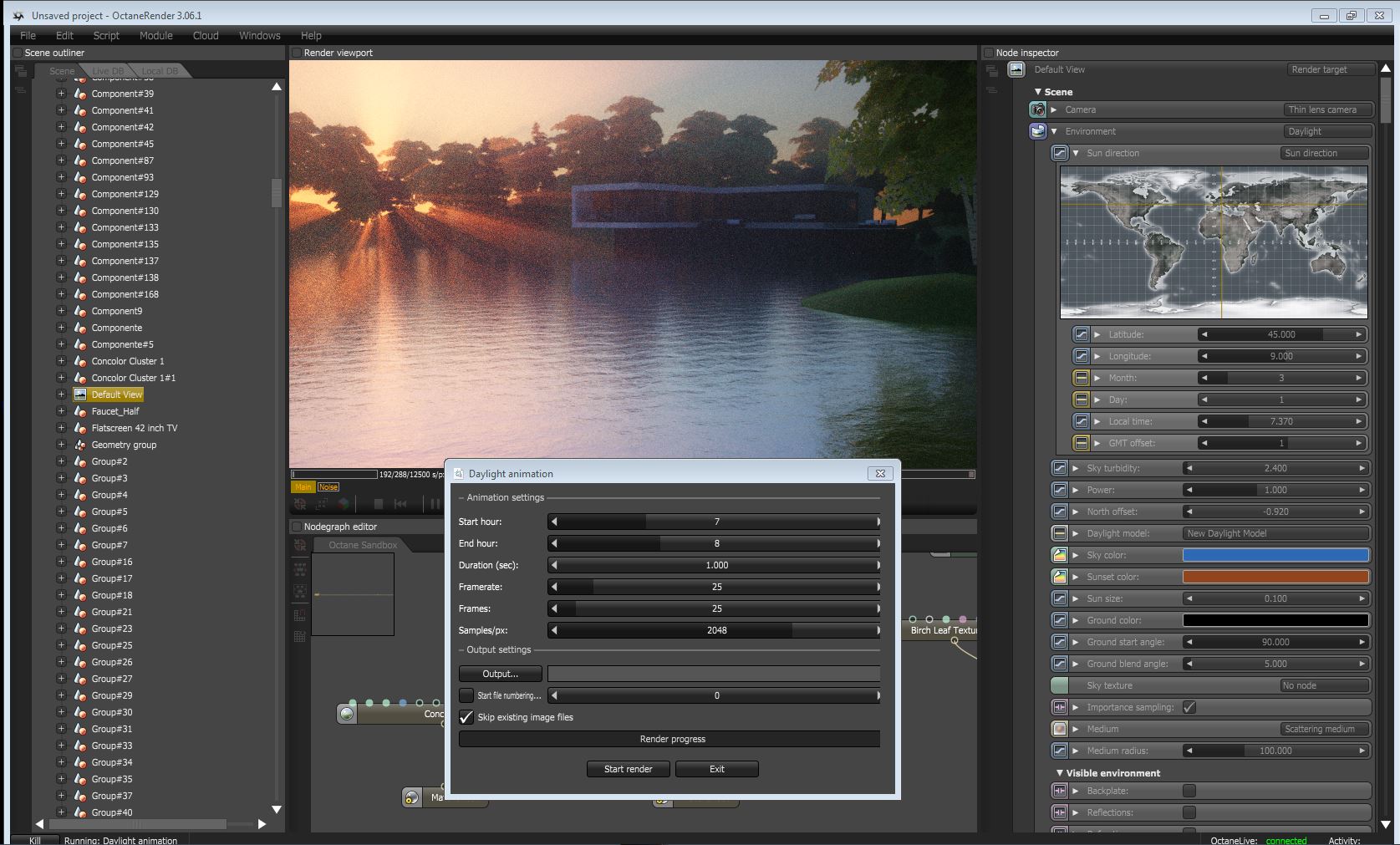

one of the most interesting features introduced by Octane Render for SketchUp 3.06.1.4 Test Release is the possibility to use Lua scripts and Lua Scripted Graph nodes inside Sketchup, to greatly expand and automate your workflow.
First of all, you can start by trying the default Standalone scripts like Daylight or the Turntable animation scripts:

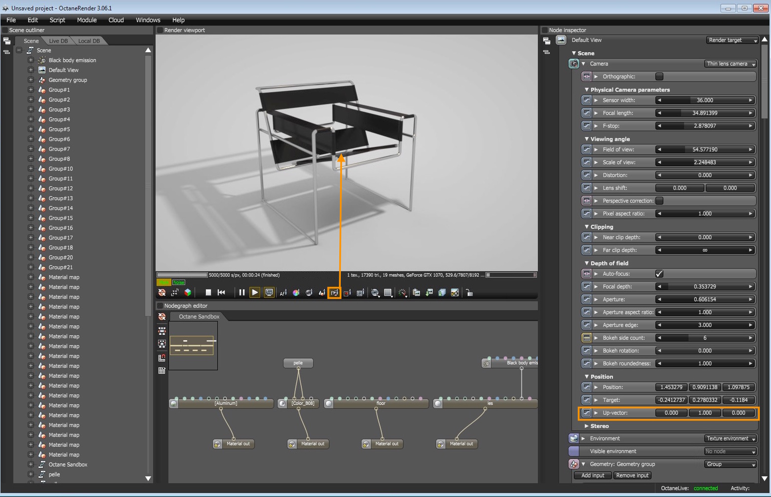

Note: you need to select the Default View Render Target node with a Daylight node before performing the Daylight animation script, while you need to firstly center the view with the proper picker, and correct the Up-verctor value to 0, 1, 0 before performing th Turntable script:

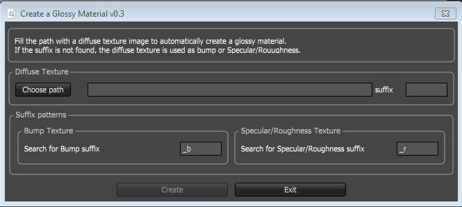

Texture2glossy
Here is one of my simple scripts modified to work with Sketchup plugin, it creates a Glossy material starting from a Diffuse image texture path. It is possible to specify the Bump and Specular/Roughness suffix to automatically find the textures, if not found, the diffuse texture in grayscale mode will be used:
Texture2glossy.lua
