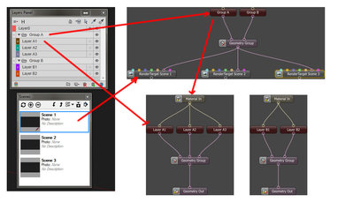

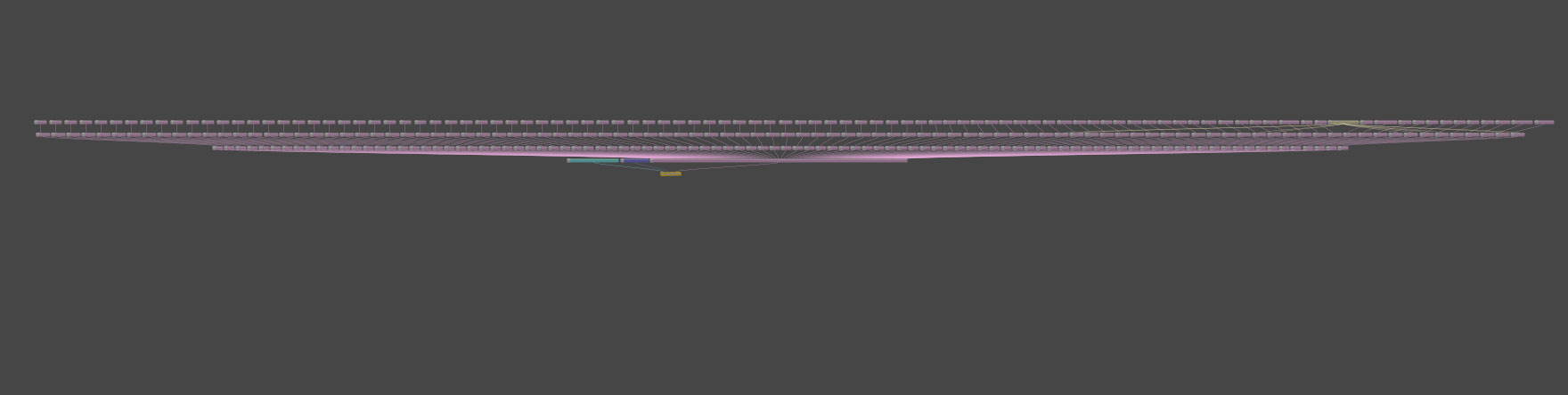

The major drawback is the way the .ocs scene is exported. For large models everything is put into one group and a user is given total mess. If you look at the screenshot you see what I mean.
1. Every visible layer should be a group.

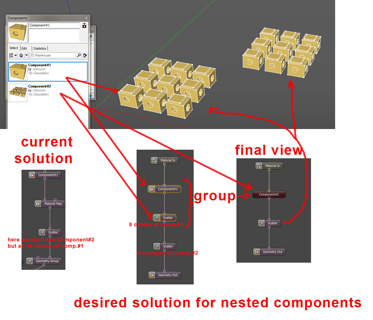

2. Ever visible component should be exported only within a group or a component. So for nested groups/components we should see scatter nodes pinned into scatter nodes. Some time ago I posted a tutorial of how to use TIG's exporter and the scatter plugin.
http://render.otoy.com/forum/viewtopic. ... components
For example, if we have 10 copies of the as same component, and these form a new component, which is copied 4 times we should see an obj pinned to a scatter node with 10 elements pinned to a scatter node with 4 elements, not an obj pinned to a scatter node with 40 elements. This is extremely important for texturing and coloring instances. It also introduces order in the node graph.
3. Every SU group/component that contains any element - group, component - should be grouped.

Here are my basic ideas of how I see the exporter.
1. Start with creating groups for layer groups - the exporter shall support the layer panel plugin.
2. All layers shall in in appropriate groups.
3. All scenes are exported as render targets.
4. to be continued
Please send your ideas.
4. to be continued

4. Components that contain other components should be grouped and then scattered. Shortly speaking scatter nodes should not include information about components that are outside other components or groups. This is the key to introduce the same order as in Sketchup. IMO this is the most important feature that ocs exporter should have.

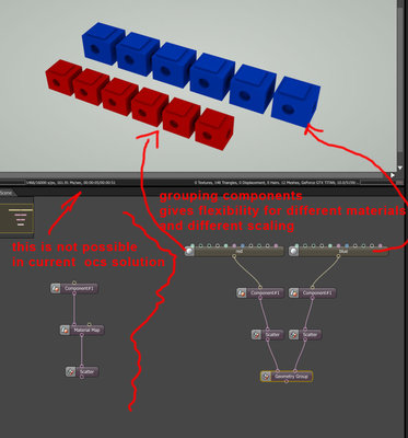

Here is another extremely important reason why the Standalone is superior for texturing.

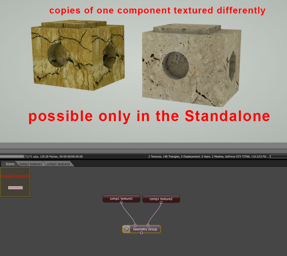

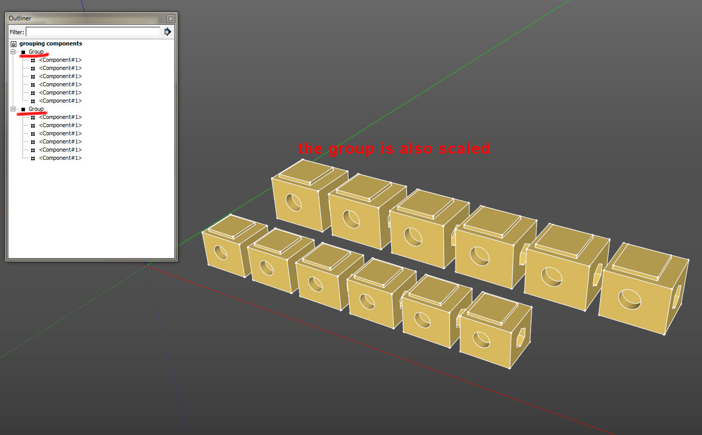

If I group components e.g., into two groups and export them with independent scatter nodes (one group of components will be scattered inside one group, and the other inside the second group) I can assign different textures to these groups.
On the screenshot you see the same component textured differently.

So anyway the nodal structure is very important, and the .ocs exporter shall take it into account.

And here is another example why the current ocs needs a proper structure.
