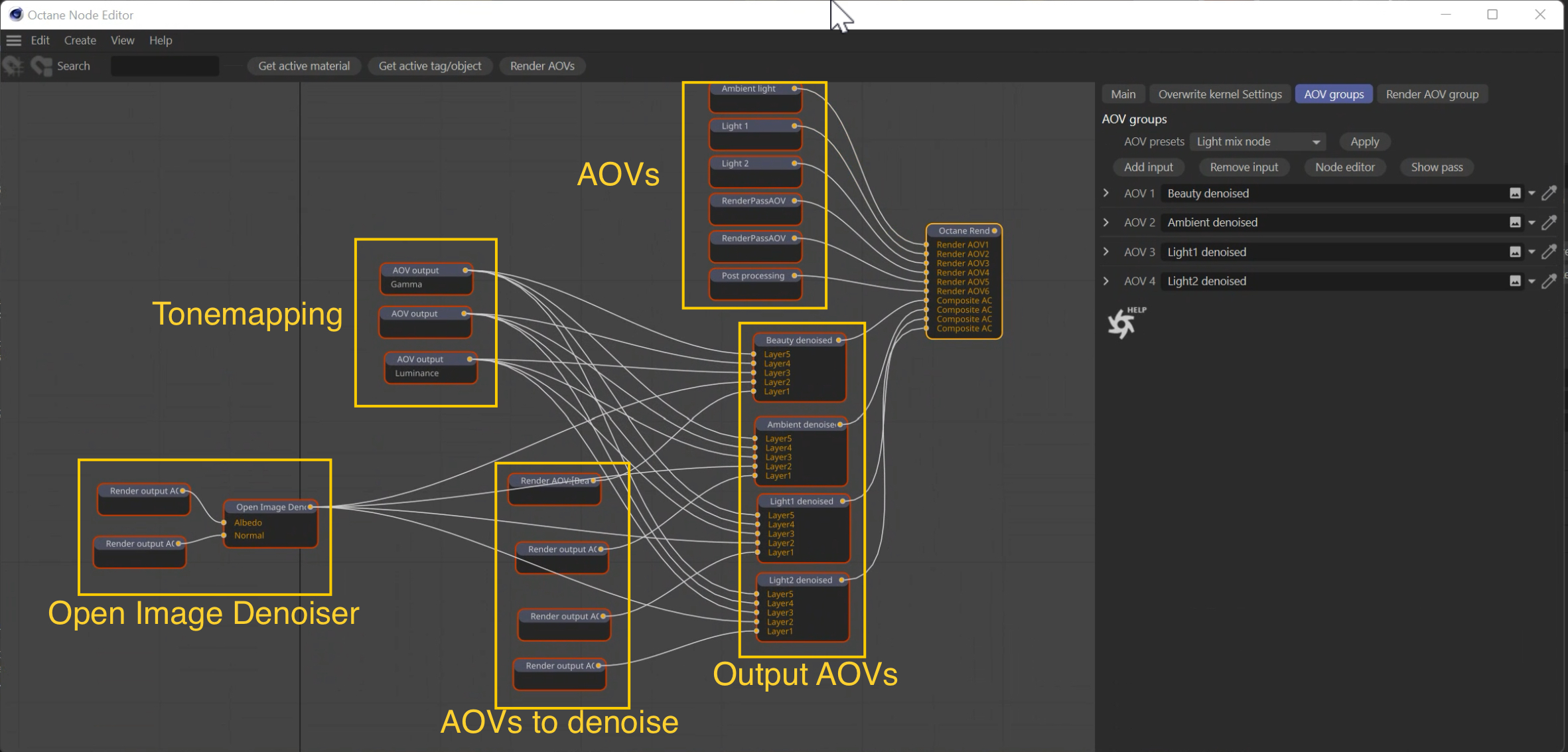

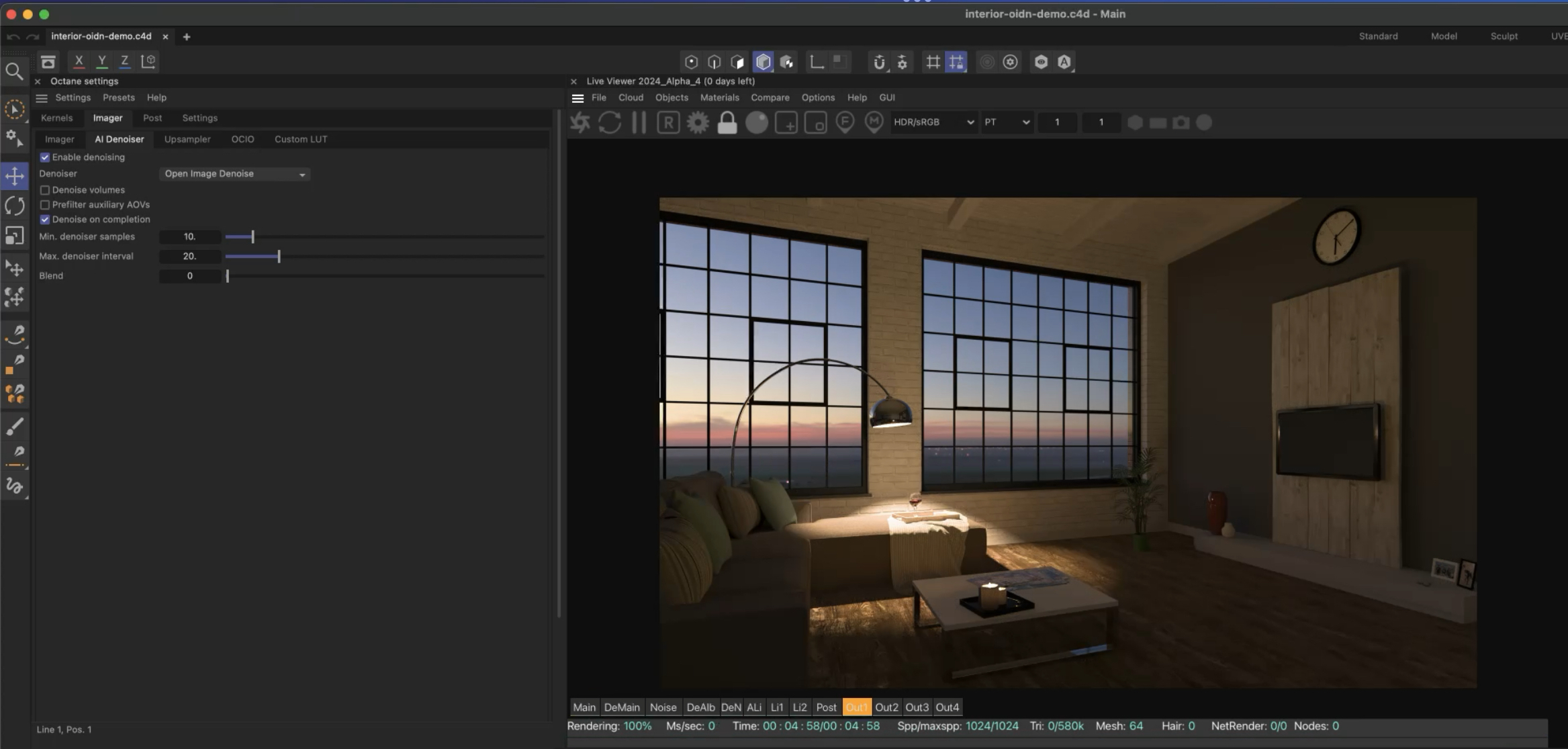

So I have converted the Standalone example scene to c4doctane, to better catch the differences in Render Settings - Node Editor:
Basically, you need to create an Output AOV group for each AOV that needs to be denoised, then connect the AOV node, then the Open Image Denoiser, and on top, the tonemapping nodes:
Here is the scene:
