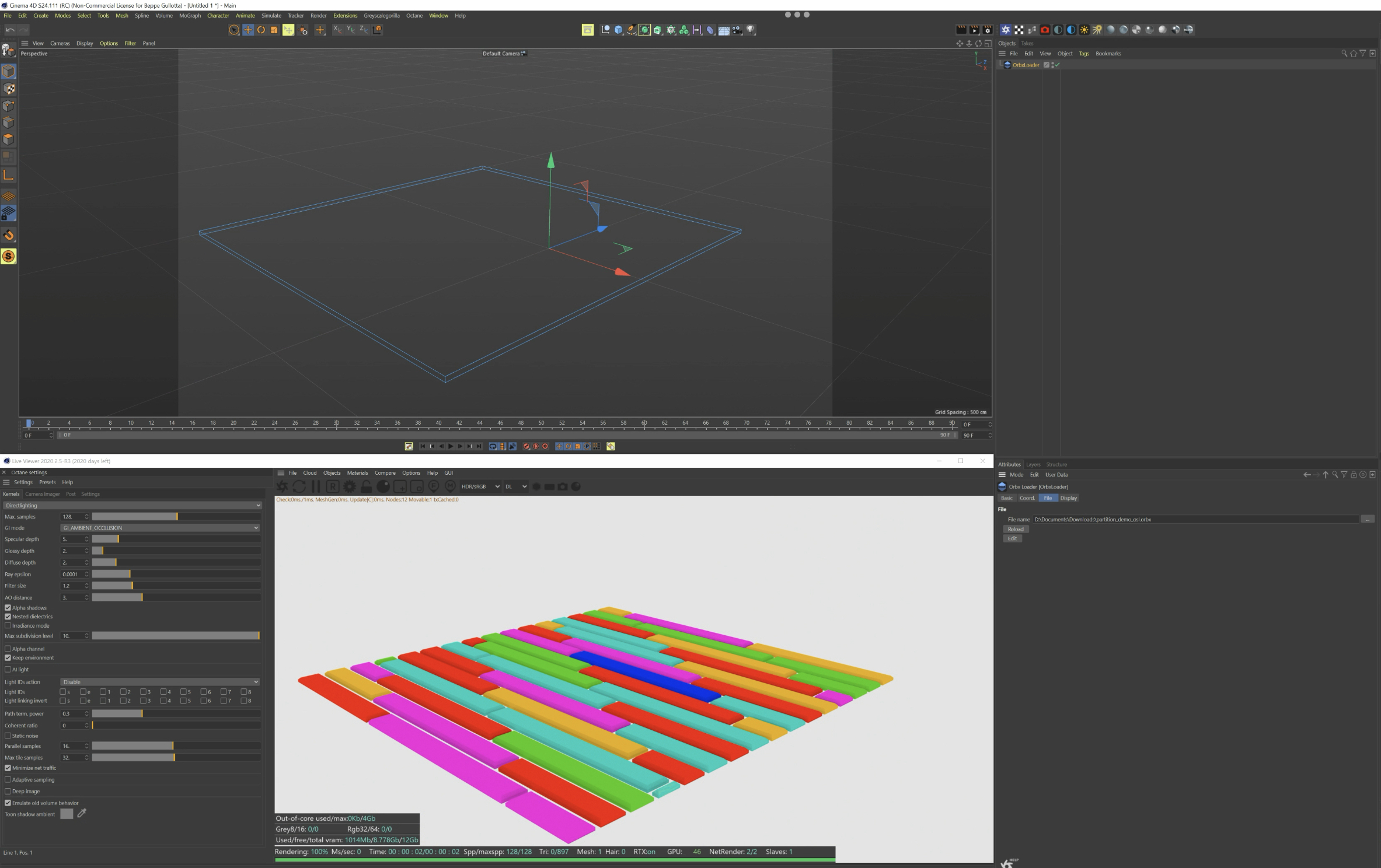

in Standalone this can be done via Lua Scripted Graph, not available via plugin:
viewtopic.php?f=73&t=78385
But you can prepare your mesh in Standalone, save as orbx, and import back in c4doctane via OrbxLoader object:

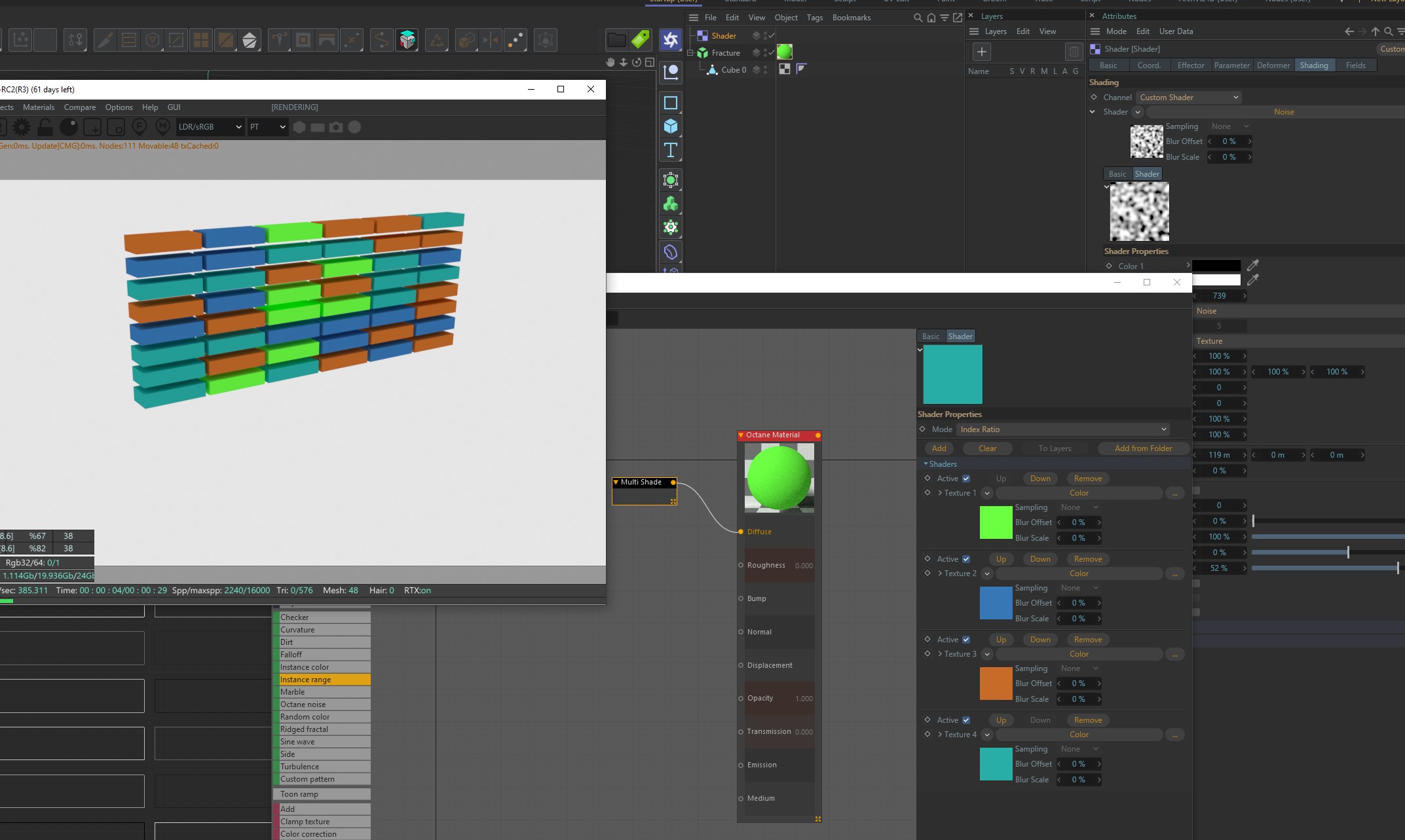

Try to fracture object and play with Mograph MultiShader :
