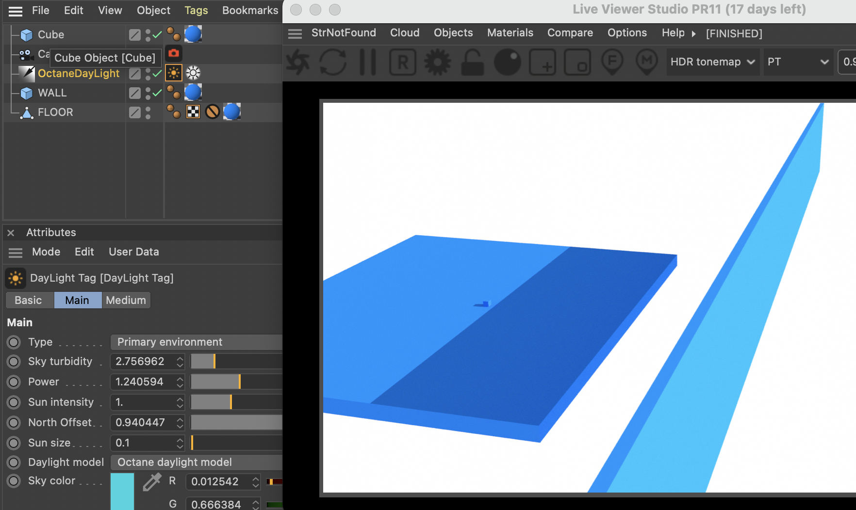

Hi, I'm using a daylight object with a shadow cast from a faraway object (this needs to be for various reasons):
Wide
Wide

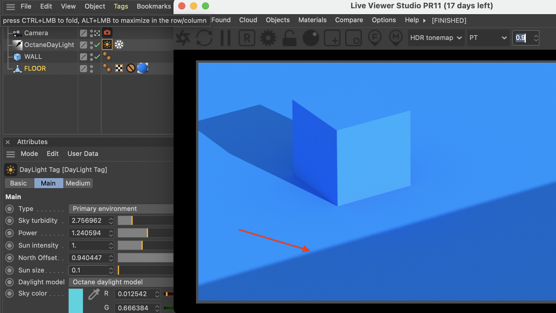

I noticed that the shadow edge is soft, even with the sun size turned all the way down:
Close
Close
Is there a way to force this to be hard without moving the object nearer?
