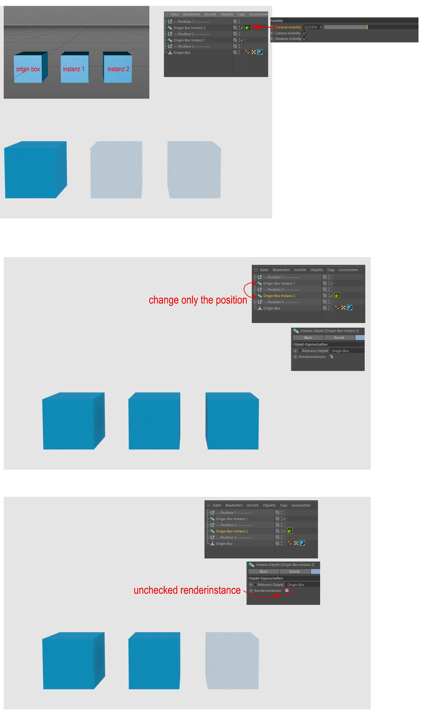

I found another bug that your team should investigate. I was annoyed to have to re-render images again because buildings suddenly became invisible. Although they don't have an OctaneObjectTag.
I gave an instance a tag with 0.2 visibility.
If this instance is placed "below" the first instance nothing happens, it does not become transparent. If I put the object on top, ALL instances will be transparent, even those below that have no tag at all.
And if I deactivate the rendering instance, everything is displayed correctly.
this is crazy !!

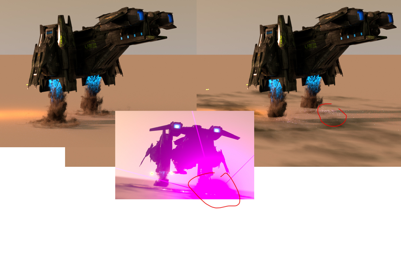

But now, i have another important question to you. I know hat thepixellab calling you about this problem.
When you use two VDB Objects obverlapping, then we have a light artefact, extreme white pixels.
I tried to use same Volume step length. but same problem. Look to my picture, you understand. One Smoke floor and one Smoke effect on top. Same problem when you use Explosion VDB and SMoke VDB. dont work. And other problem, i cut the VDB overlapping container.
Hope you can help. Its really dont made fun to work so. Every time when i need two objects, i must fase our in my animation, kill the smoke floor, and then make second VDB. it looks really bad.
Thanks so much !!!

Also note that overlapping VDB issue is not a plugin issue, but a problem of the general SDK.
