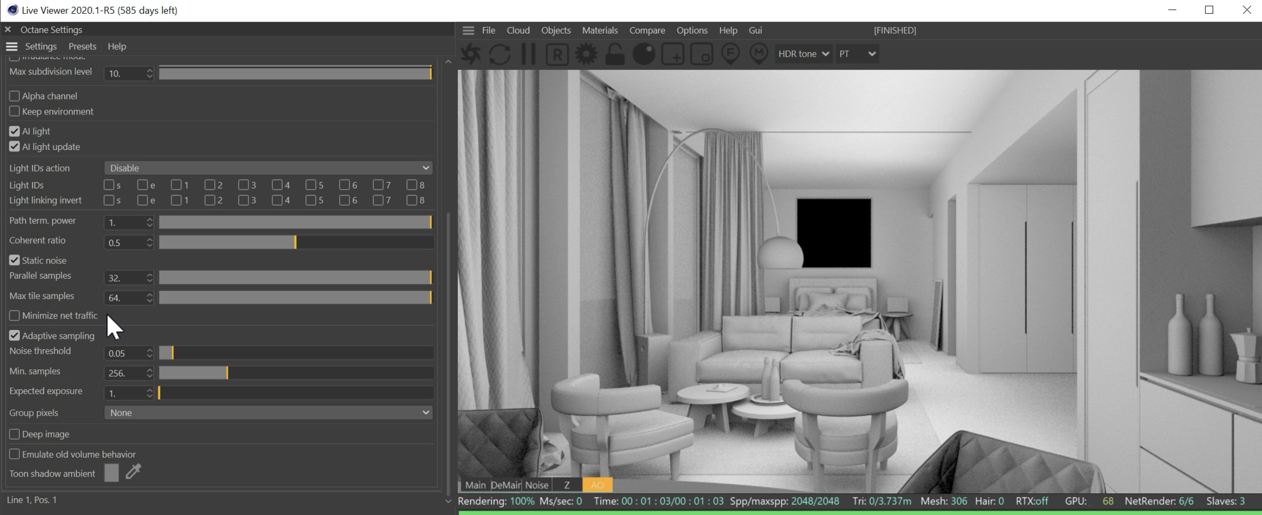

Hi all,
I have an issue that I have been experiencing I think only since Octane 2020. Sometimes my ambient occlusion pass has this weird lighter/darker separation. It looks like it's split in the middle (I also have it sometimes in the render... I think in the latest one, it was split in quarters, not half)
I have the latest version of Octane (2020.1 R5), my studio drivers are up to date. It looks like I have the same issue whether RTX is on or off.
I have 3 graphics card
- 2080
- 2060 Super
- 1080
Plus a 1070 on another computer on my network...
Actually, as I was writing this I wanted to see what happens if I turn off Network Rendering and it looks like it got rid of the problem. Do you think it could be the reason? If it is, is there something in the settings to fix that. If not, then what could be the cause?

everything is working correctly here with AO pass and Net render:
Have you disabled the Minimize net traffic option?

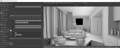

That clearly didn't do the trick
Now there is the quarter thing I told you about. I'll continue investigating on why it does that, because it's clearly an intermittent thing and I don't think it happens on the full rendered sequence. My money is still on the network render (I unchecked the minimize set traffic option... )
Funny, it actually change quadrant every frame or every other frame like so
For that project it's not such a big deal, I was not really planning on really using AO for the final compositing... And if I need I probably can render an AO sequence from the standard renderer on top (the octane materials I use generate a little of AO, but I can live without it)
I'll look into aoktar's suggestion with the linear color space. The problem is that this issue seems to pop up randomly so reproducing it might be tricky.

Posts: 10661
Sorry, muftix, we were able to identify and correct the issue with AO pass and Network rendering, and will be part of the next SDK update.
