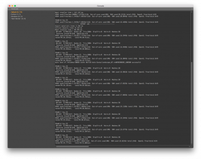

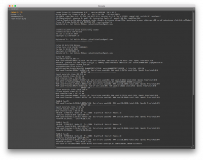

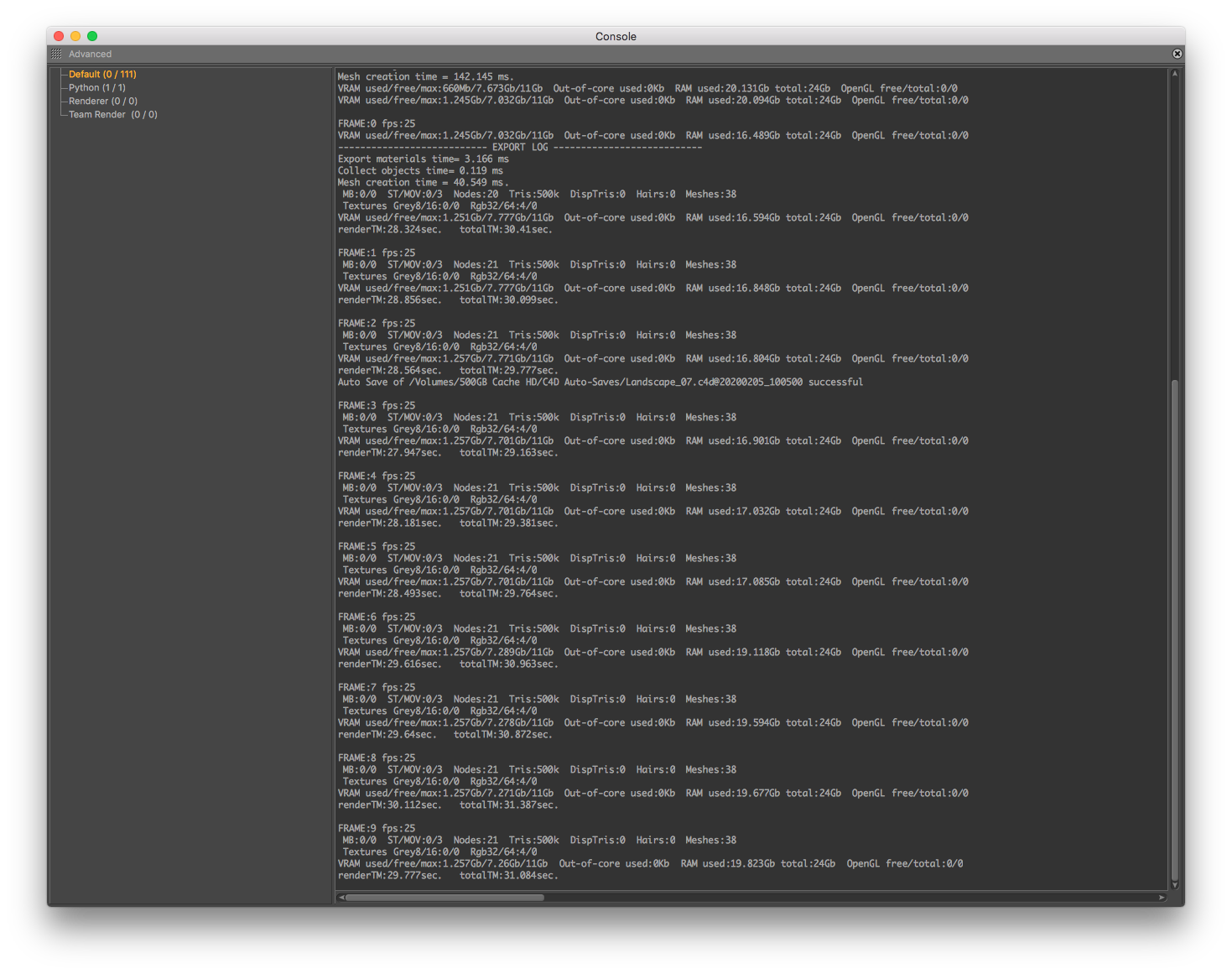

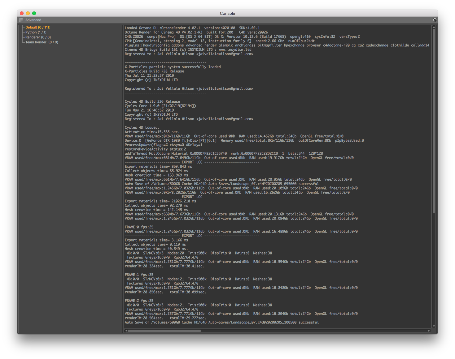

Question has been asked a few times but greatly appreciate your analysis of my situation.
Octane renders image in 13seconds but the "preparing" time last over 2mins D: My fear is that my processor is too slow.
Attached my console reports. Please let me know if any other information is needed.

You can see times for different phases of exporting the scene and also for render times.
He I cannot see here any times long as minutes.
