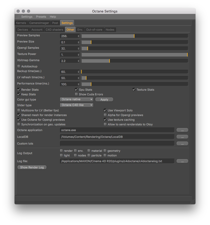

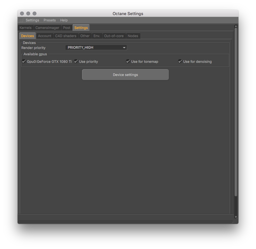

Please, also share a screenshot of c4doctane Settings/Devices, and Others panels, thanks.

Thank you Beppe.
Yes my 1080ti is running my displays, I have two Apple Cinema Displays connected to it.
Here's a link to my .spx file: https://www.dropbox.com/s/w0w5m9m9j4xl3 ... o.spx?dl=0
Requested screengrabs

Having 2x monitors with only one GPU is not the best.
Better to have a dedicated GPU for system/monitors/OpenGL, and leave the GTX 1080 Ti for rendering only, you will also gain some VRAM.
Anyway, your Priority setting is wrong, please change the popup to LOW, if set to HIGH is like no Priority, and the GPU does not keep some power for system/monitors/OpenGL.

Thank you Beppe, understood about running 2x displays off the card I'm using for rendering. I'm just hoping Octane X and the new Mac Pro will be out before I have to add any new hardware to this setup though. I've set Priority to Low, thank you for the pointer.

Just wanted to update this thread in case anyone else searches for this issue - setting GPU Priority to LOW as per Beppe's suggestion has solved my probelm with Octane crashing. Been using it all week and not had a single crash or beachball. Octane's output is just beautiful to me, glad I stuck with it and thank you again for helping Beppe.
