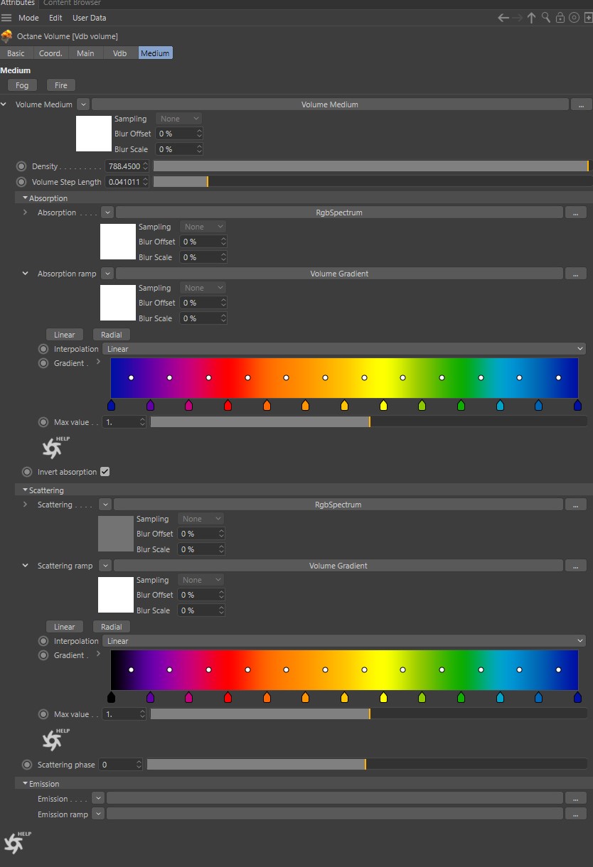

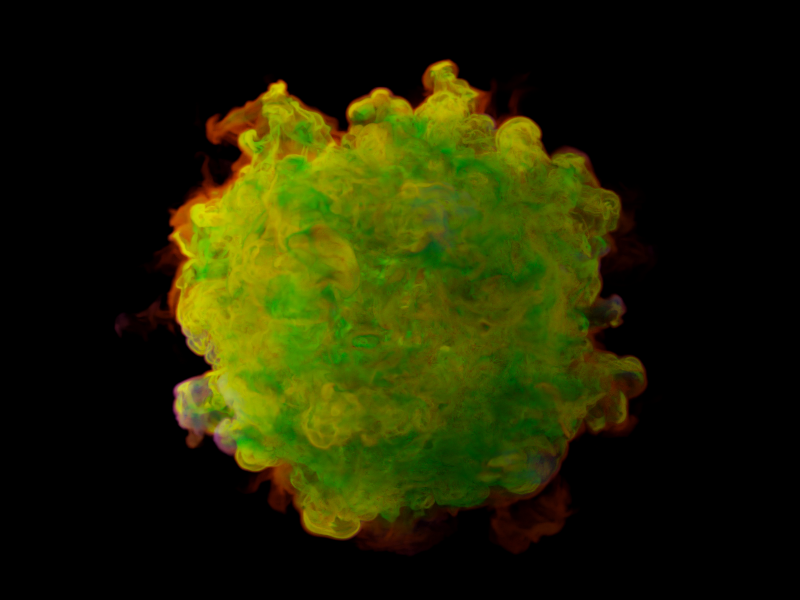

So I'm not really sure that you can bring the color channel from the VDB export from X-particles in. However, you can create color ramps based on a specific value, in my case, I used density and a bunch of colors.
To achieve this look from a single VDB volume. As far as mixing the colors, you might be able to produce an optical illusion, which would be physically accurate since smoke never actually mixes together (it's particulate matter).
For XP, you'd have to have two separate cache exports as VDB, then bring them back in with two separate VDB loader objects. Color to taste and see what happens. Here's my result using the above method:
