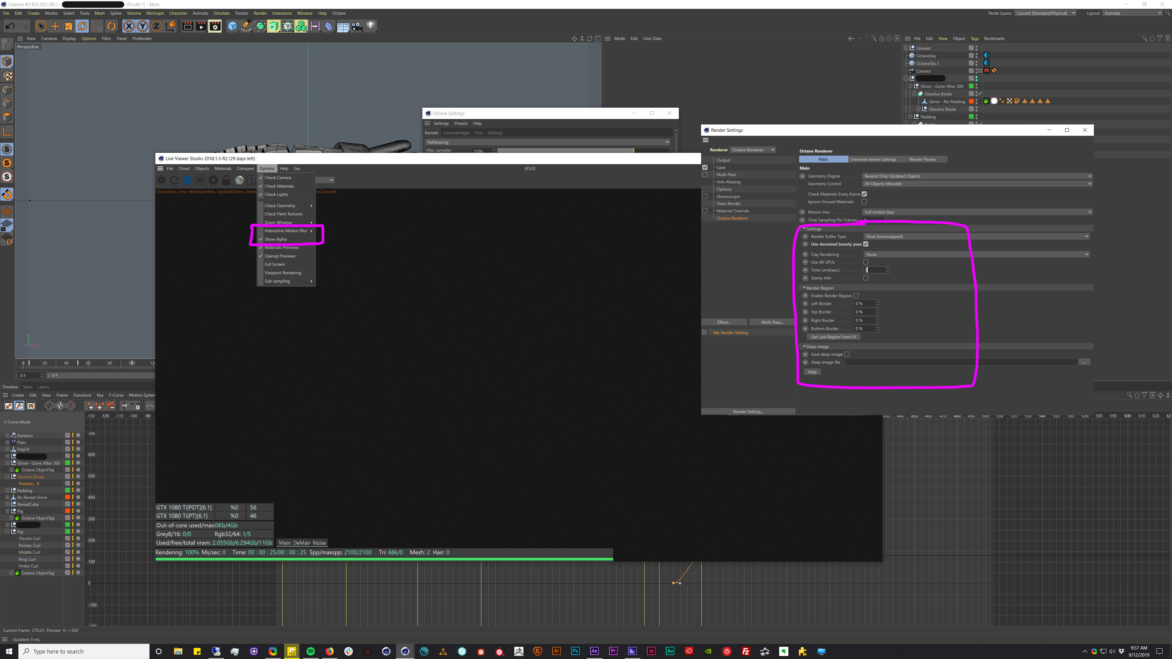

Hey all,
I just updated to C4D R21 and updated my octane version to the R21 build here ( viewtopic.php?f=85&t=71723 ).
For some reason when I updated to the R21 version of octane I cant find the Network Rendering checkbox or dialog in Cinema's Render Settings nor any of the Octane dialog windows. Anyone know whats going on here? I posted some screenshots below - circled in pink is where my network options used to live in my previous version of octane. Any thoughts here?

Posts: 10633
only v4 Studio versions have the Network rendering option active, but it was an exception.
Normally, only regular Enterprise licenses have Network rendering enabled.
You need to go back to v4.05-R5, if you want to use Net render with Studio licenses.
ciao Beppe
