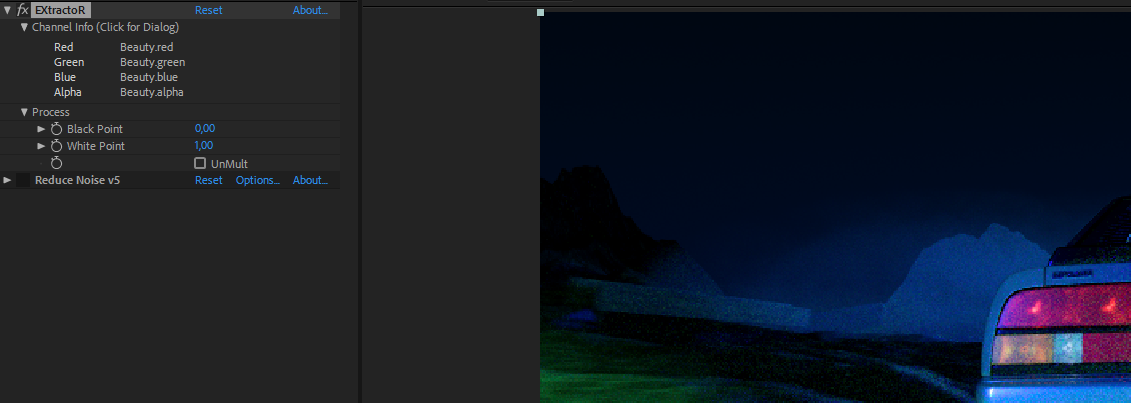

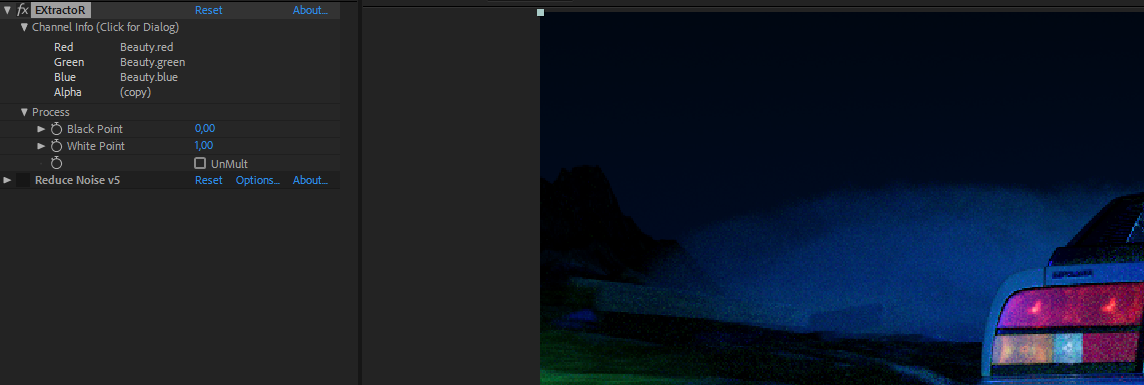

I have a problem compositing my background in After Effects.
I have a few OpenVDB in my scene. I rendered a pass for Environment and in the Kernel setting I enabled "Alpha channel" and "keep environment".
In After Effects, when I enable the alpha channel on my Beauty pass and put my Environment pass below, the transparency from the VDB is messed up. In the attachment files you can see the expected result when I set the Alpha channel on "copy". But in this case I loose the transparency to composite my background.
Any solution ? Does my problem come from Octane bad setting or After Effects bad compositing technic ?

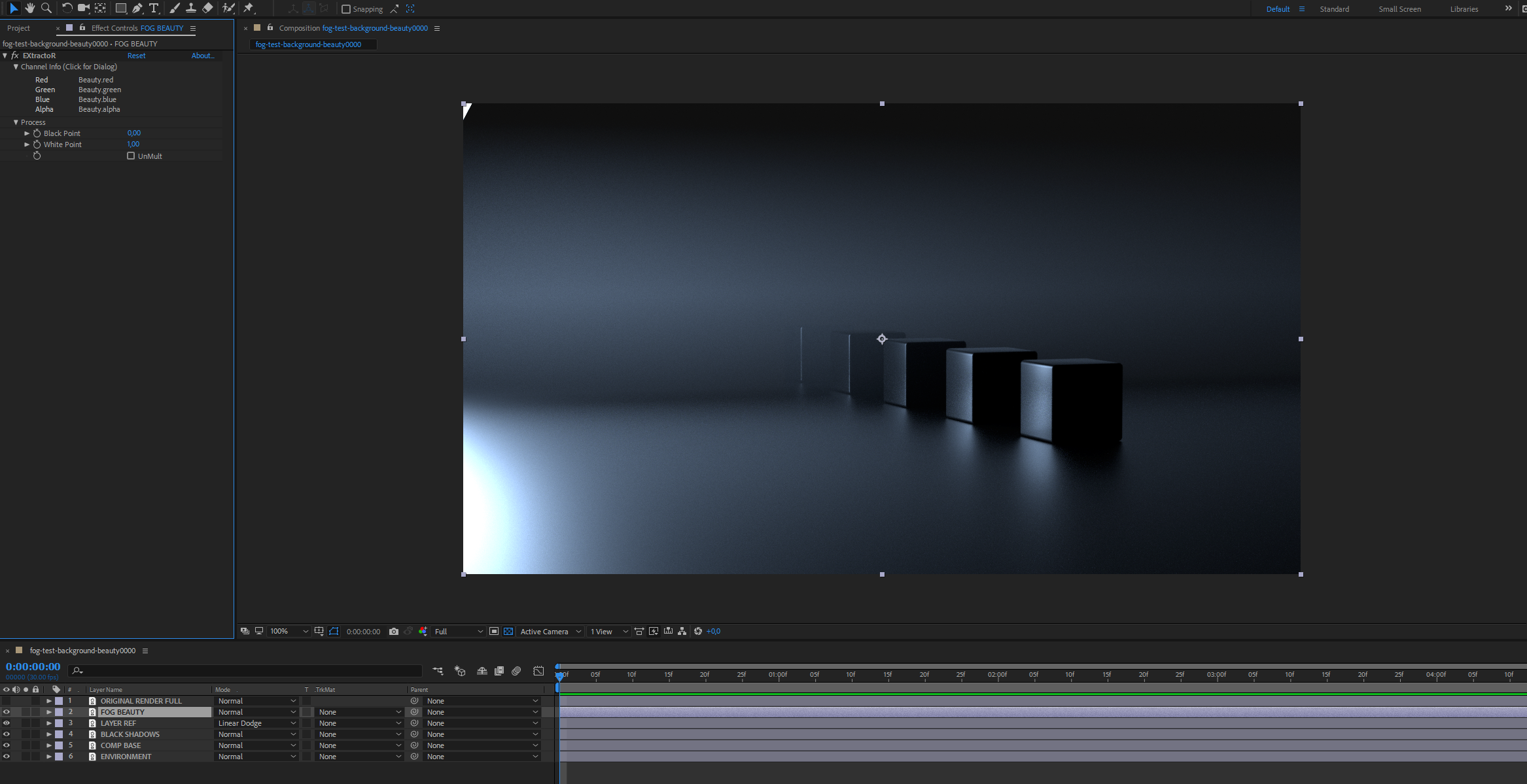

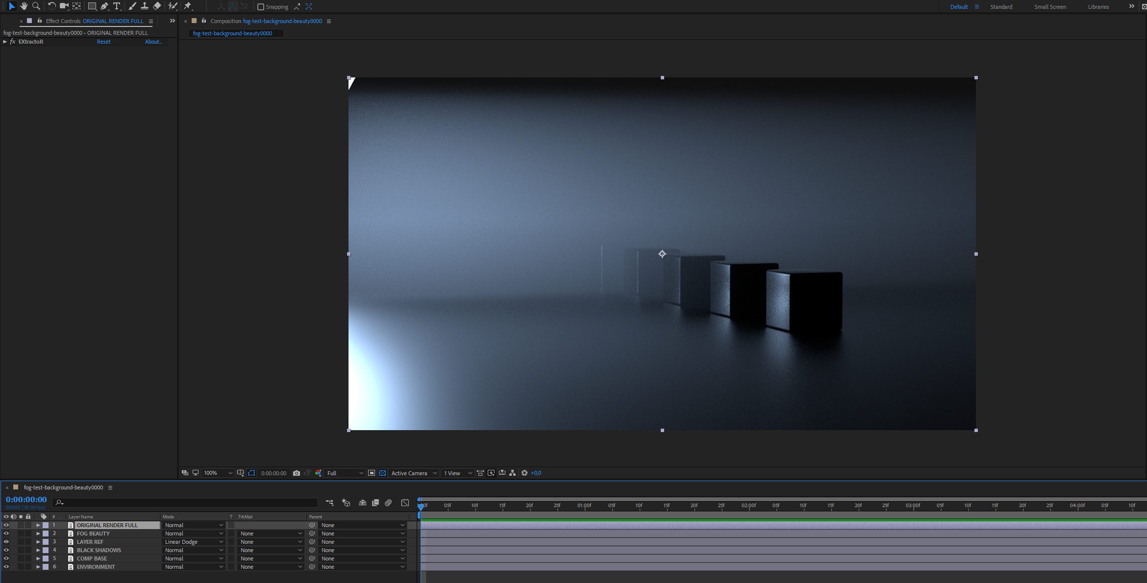

Another exemple in a little test.
If you see the pictures attached below :
- First one is the beauty without any passes.
- Second one is a composition using Render Layer for the volume object. Using Alpha Channel in Octane.
It is obvious that the volume rendered with Render Layer Pass is way more transparent than when render within the beauty.

You're not mad, i've had this problem too.. The only ( hacky) solution i've had is to play around with material qualitites of the VDB in octane to make it a thicker material. I cant remember the exact setting as im not near my work comp, but it is possible to thicken up the alpha matte without totally changing the look of the smoke.. i have to jump back and forth to see the alpha matte to see if its working.
then i uses curves in after effects to fill out the alpha a little.. its a long way from a simple effective pipeline.
