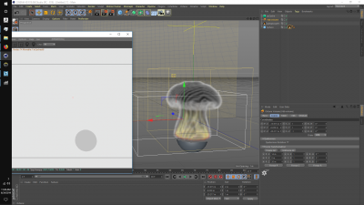

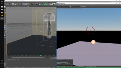

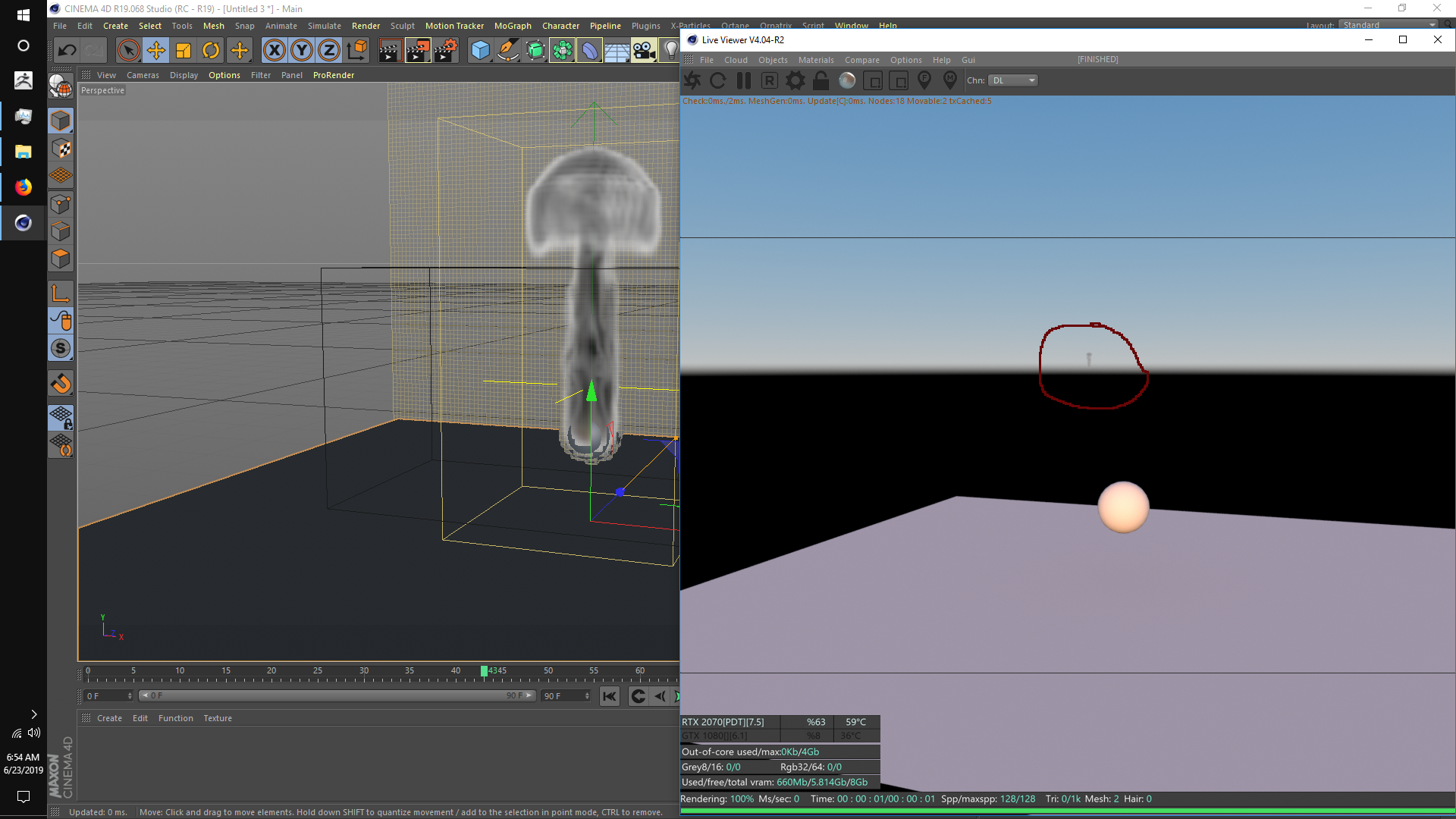

So Ive followed the standard steps to creating an explosion sequence but the actual visuals are set far out into the distance with nothing telling it to be that far. All items are spawned are by default spawned in the center of the scene.
In the C4D viewports the effects show it centered.

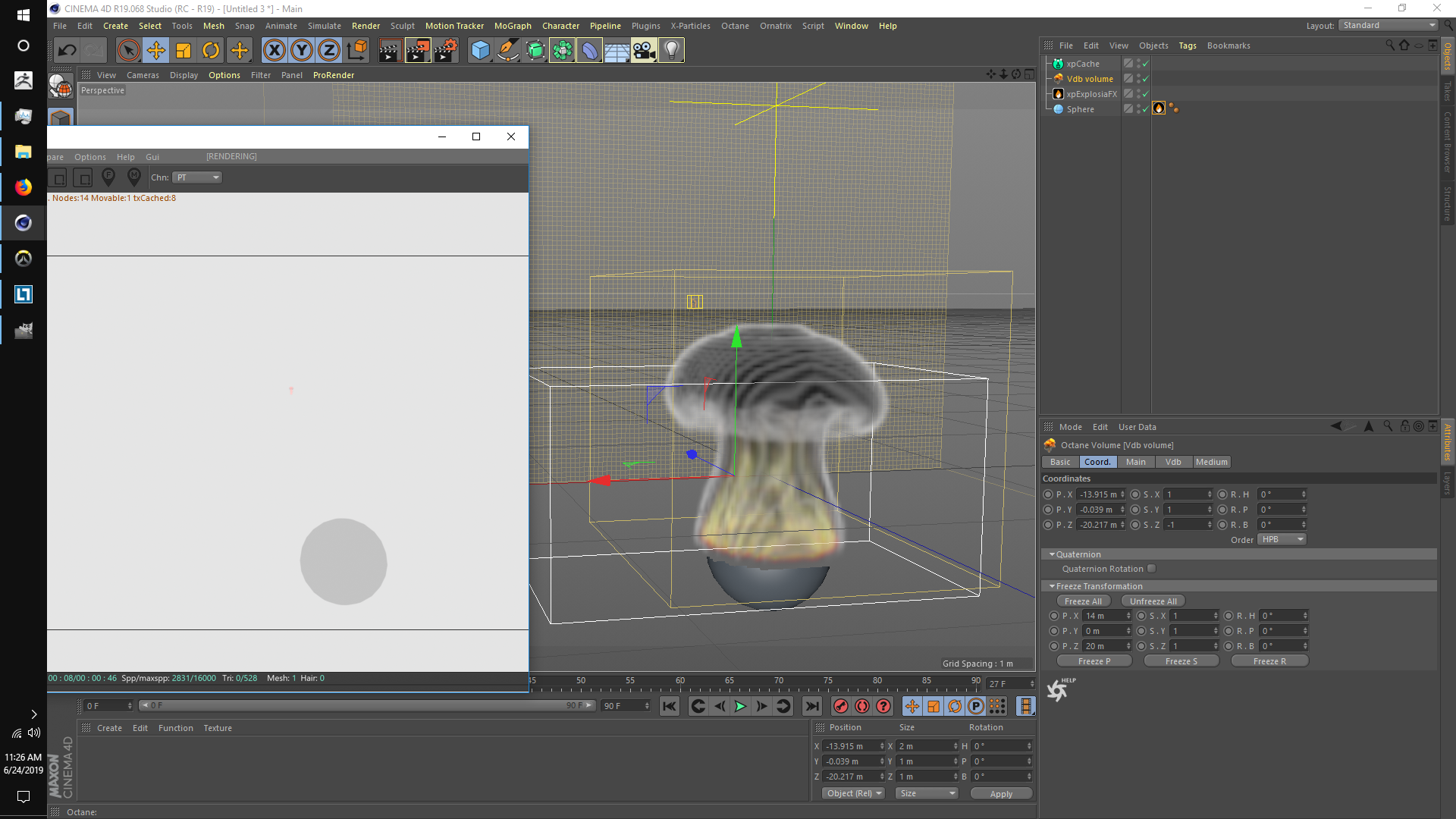

I have a rather simple setup, just spawning it in a default position in the middle of the grid with using D:\XP_Cache\xpExplosiaFX\xpExplosiaFX_000001.vdb
Position X,Y,Z ARE AT 0,0,0 meters.
VDB Loader
0 offset
0 start
90 end
6 digits
The volume seems to be the only thing affecting its position because when I move it the whole particle effect moves with it unlike the other things in the scene (xpCache, epExplosiaFX, Sphere w/ exEFX Source Tag.)
