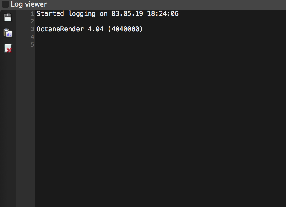

As you can see in the attached screenshot, the log doesn't seem to show anything once the freeze happens. Again, nothing seems to be locking up in the program. I can move windows around, but nothing can be interacted with and my yet my computer says its not frozen. Downgrading from 4.04 to 4.01.1-R2 fixes the issue. Versions above that seem to not work as far as I can tell.

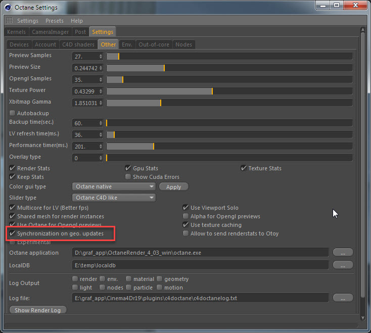

Is it happening on a specific scene or any scenes? What happens if you disable previews for Nodes?
And what's up with this parameter? Checked or unchecked?

Disabling node previews seems to fix the issue. This also happens for all projects and that box is checked. So that fixes the issue, but is there a way to have this enabled and the issue resolved? If not, no problem.

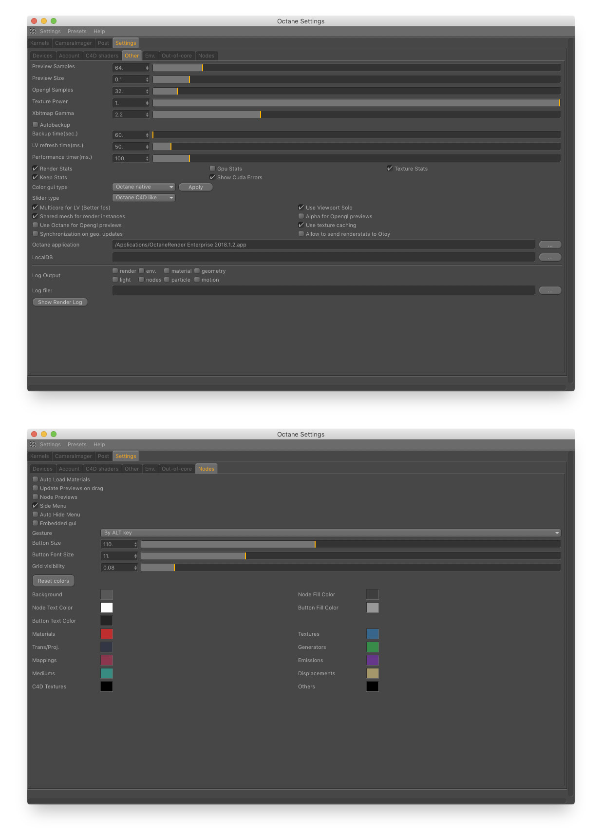

With the settings below the freezing stopped:
