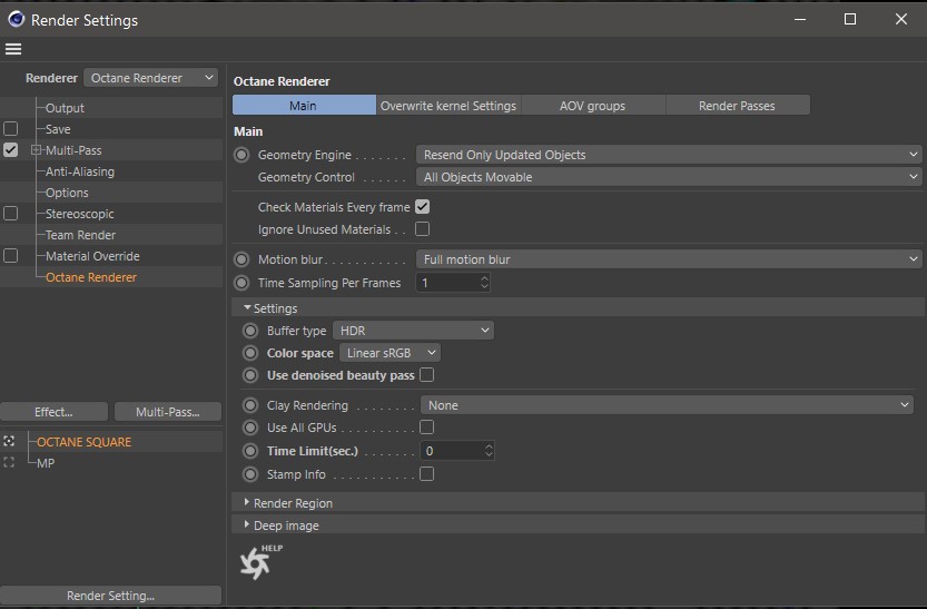

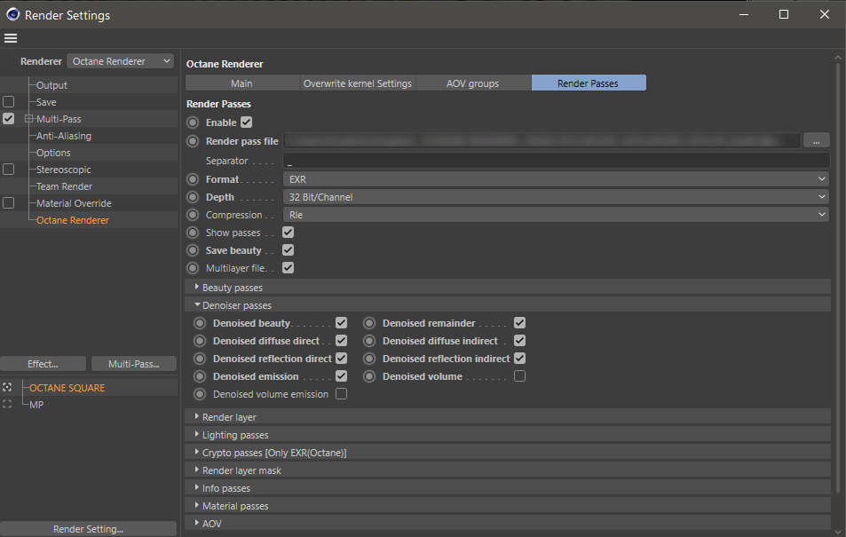

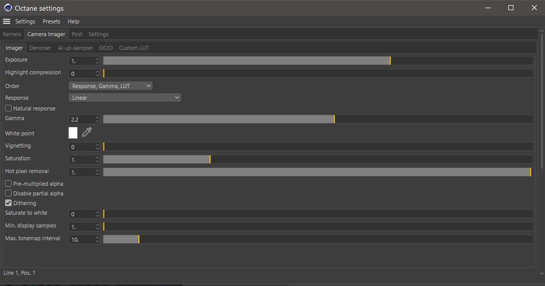

Hello everyone,
I am taking up this post again a few months after this discussion because I have just taken over an Octane licence and I am trying to solve this mystery. If I understand correctly, you can't output a 32bit linear exr rendering (for example) and have a motion vector pass that can be used in after effects. I enclose screenshots of my settings. Can you tell me if I make a mistake or if I misunderstood. For this project, I had to take out my compositions in linear and redo a complete tonemapped rendering of the motion vector pass. I'm not sure this is the best way.
Thanks in advance.
NICO
C4D R21 + OCTANE 2020.2 R3
Posts: 16068
Location: Türkiye
You'll see same results if you select same colorspaces on LV and PV. Not a mystery

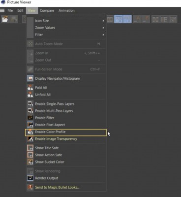

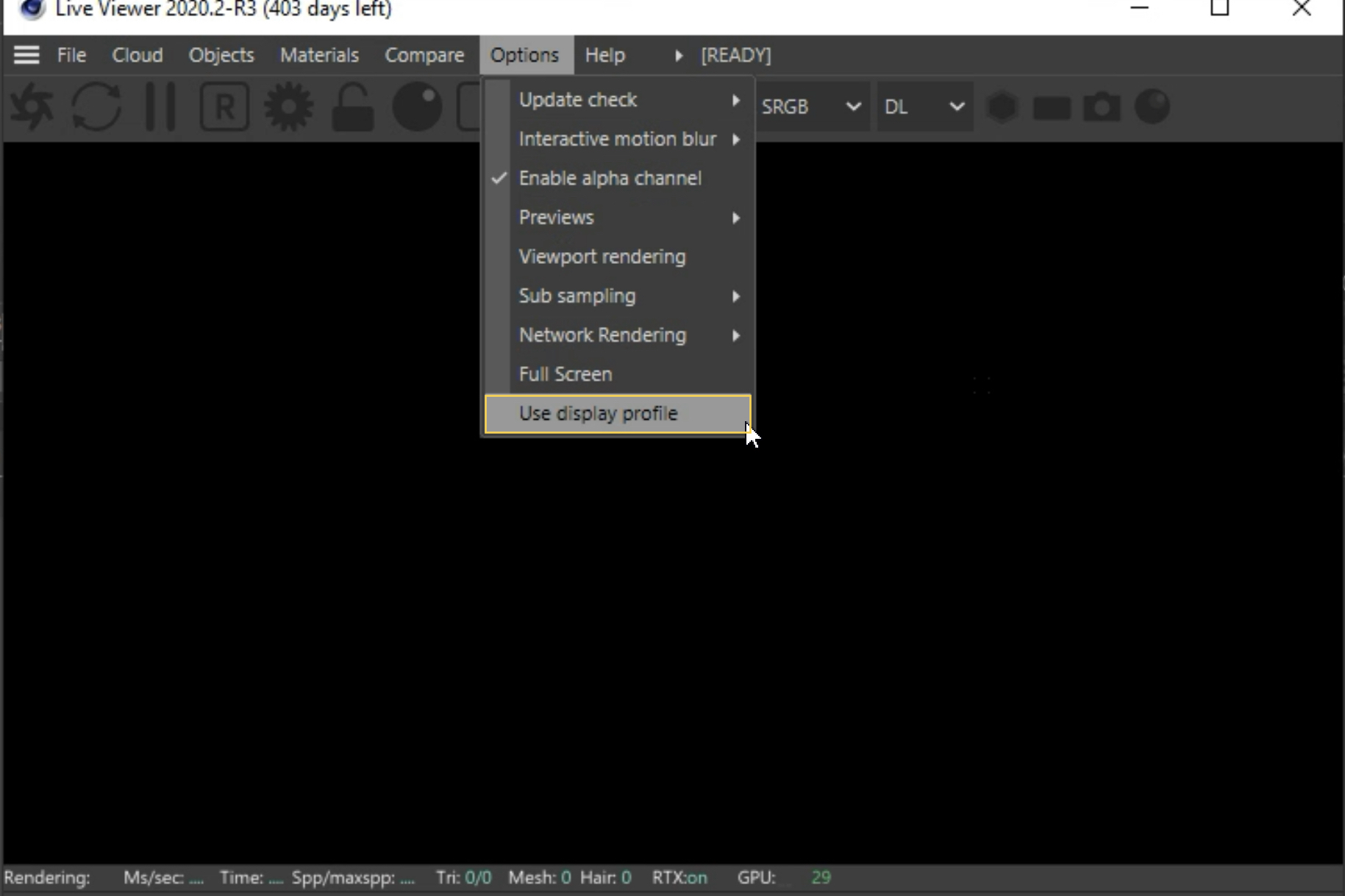

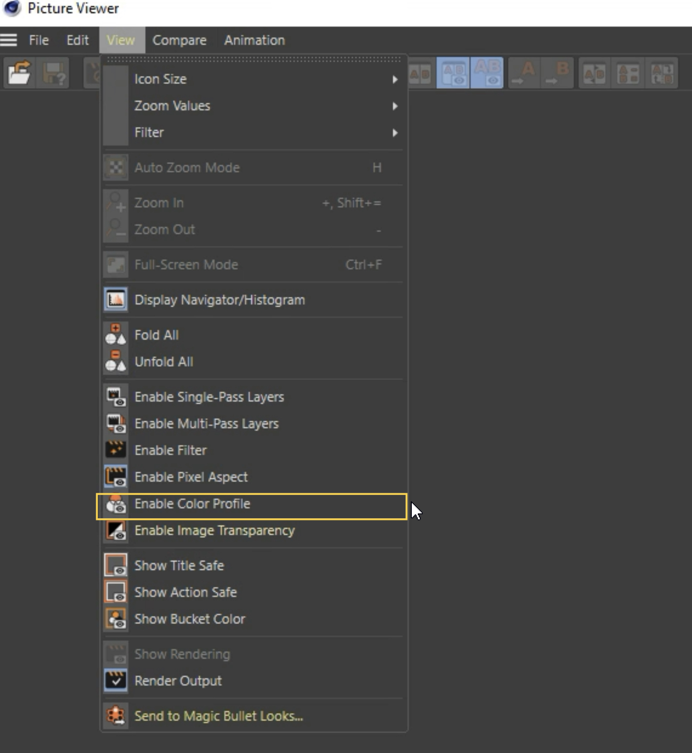

Please also check to have disabled Use display profile in Live View menu Options:
And disabled the Enable Color Profile option in Picture Viewer:
