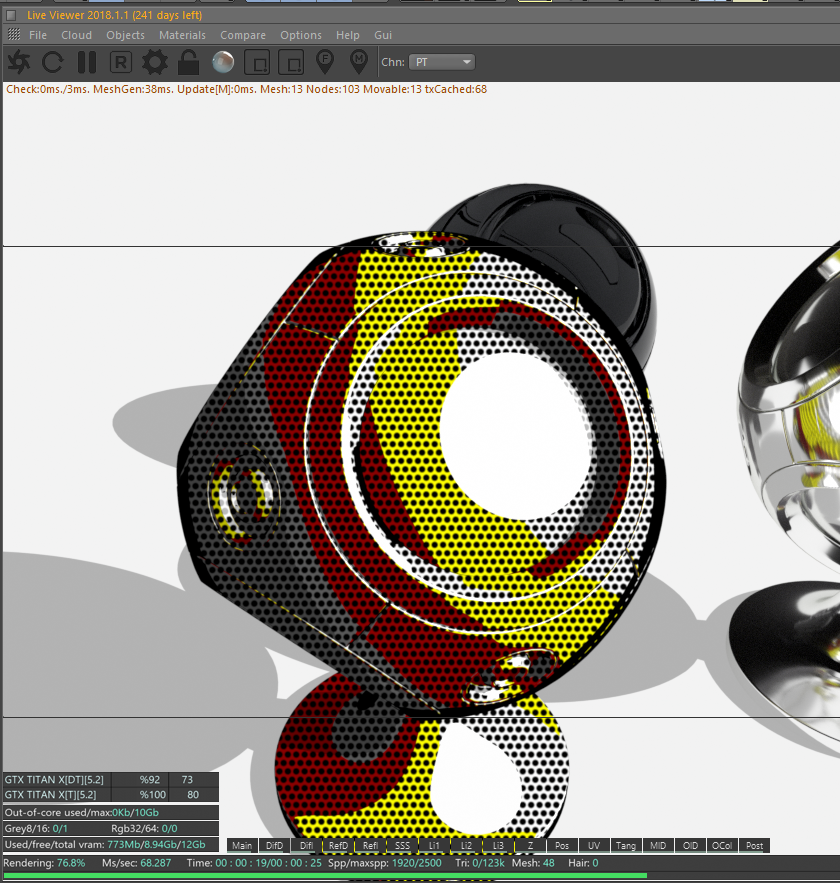

I have two toon materials and try to use ToonRamp shading information to mix them. The point is - I want the dots to appear only on a specific color of shading. Octane Blending material unfortunately doesn't accept ToonRamp as an input.
Any suggestions on how to make it possible?

bepeg4d wrote:Hi,
try with a falloff node piped into a gradient node.
ciao Beppe
I don't quite understand how it could solve the issue.
Falloff node works within either object space or point-of-view space. The point is the shading of the toon materials woks according to the toon lights.
