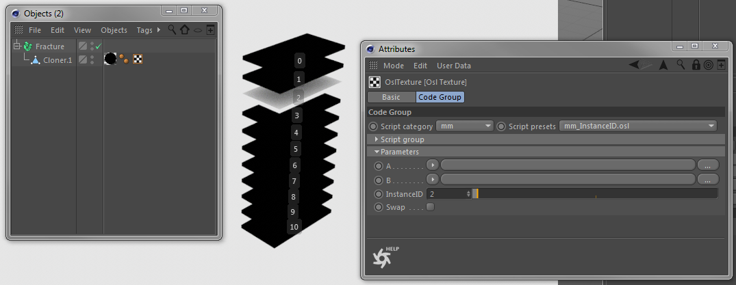

Well, for some reason builtin RandomColor node is not "seeing" the instanceID numbers in a Fracture setup but OSL does.
Instance Range works too.
This great script from Beppe should do exactly what you need.
viewtopic.php?f=73&t=69211
You can use this instead of RandomColor node. It will work with Fracture + Explode segments. Or, for example, as an input in Gradient node (complex mode) to randomize (multi)textures.
Code: Select all
#include <octane-oslintrin.h>
shader RandomInstanceColor(
		int Seed=0,
		output color c = 0)
		c = noise("cell",_getinstanceid(),Seed);
With this one you can mask individual objects based on ID. You will see that InstanceIDs mach Index numbers exactly.
Code: Select all
shader InstanceID(
      color A = 1, color B = 0,
      int InstanceID = 0 [[int min=0, int slidermax=100]],
      int Swap = 0 [[string widget = "checkBox"]],
      output color c = 0)
	color outA = A;
	color outB = B;
	if (Swap==1) { outA = B; outB = A; }
	c = (InstanceID==_getinstanceid())? outA: outB;
Cheers
Milan
