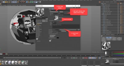

thanks for the tip ... but unfortunately it is not working here. What I'm doing wrong?
please help ... thank you!

sorry ... its the "image tile " ... as you can see it don't load all images only the first .1001 but there are 12 more. So how do I load my UDIM tiles?

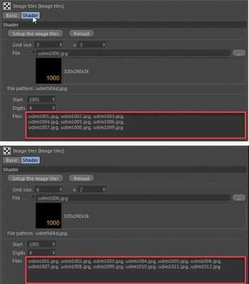

ChrisGFX wrote:sorry ... its the "image tile " ... as you can see it don't load all images only the first .1001 but there are 12 more. So how do I load my UDIM tiles?
see image...
Expected image names if you select a file with name as file1001.ext
for grid=2,2 and start=1001/digit=4 -> file1001.ext,file1002.ext,file1003.ext,file1004.ext
for grid=5,2 and start=1001/digit=4 -> file1001.ext,file1002.ext,file1003.ext,file1004.ext,file1005.ext,file1006.ext,file1007.ext,file1008.ext,file1009.ext,file1010.ext
