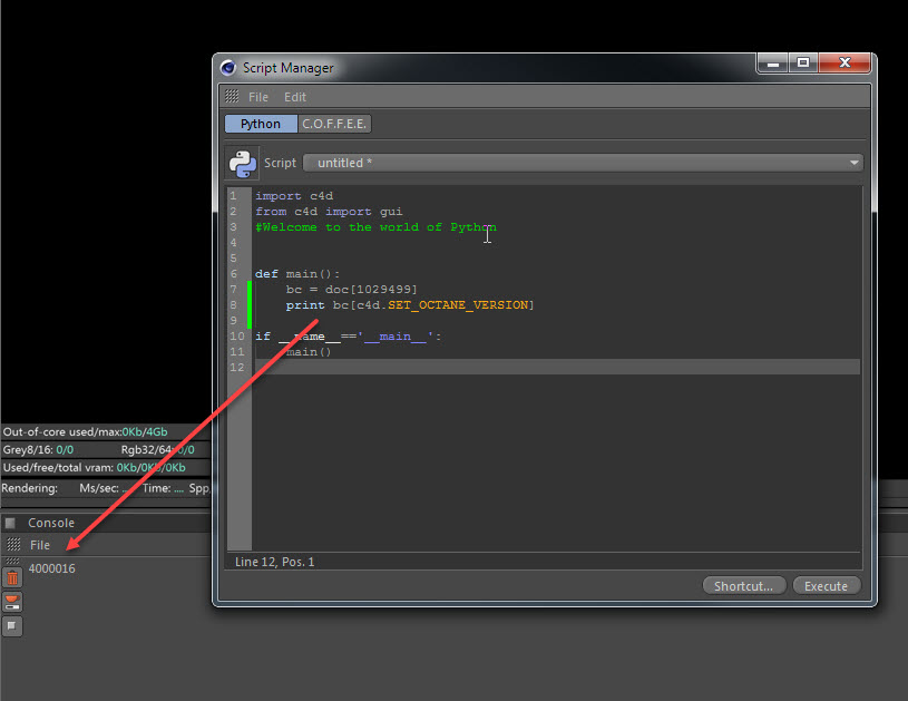

Posts: 16068
Location: Türkiye
here

Here I defined the easiest ways for this and more....
viewtopic.php?f=87&t=56039&start=10#p348597
