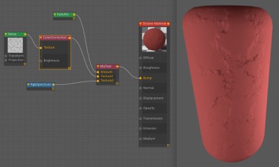

I've been reading up on the fall off node, and I have created a mix material, containing two materials, one with bump and one without. I then piped a fall off node into the amount channel of the mix material, and I can fade out the bump according to the glancing angle.
BUT - it's only an opacity fade between the bump and non-bump materials. How can I use the fall off node to fade between a high bump and a low bump according to the glancing angle? Is this possible?
mitchino
Posts: 452
Joined: Thu Jul 14, 2016 4:49 pm

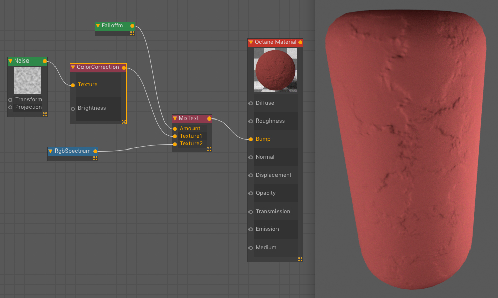

I think I've cracked it!
If I put a noise node and an RGB spectrum node set to 50% grey into a mix node and then pipe a fall off node into the amount channel, then pipe the mix node into the bump channel of my material, I can use the fall off node to control the bump so it appears higher at direct angles and lower at glancing angles. And it is actually adjusting the height rather than just doing an opacity fall-off.
Is this a good strategy? It works for me!
That was a bit of a head scratcher...

That is a good way too. But what I meant is to for example multiply the falloff node and the bump node (image or whatever).
And then set the falloff from gray to black or from white to gray or whatever you need.

I have to say your setting is way better than mine. I seem to have mine mixed up with something because I couldn't get it to work how I had it remembered.
So thanks for teaching me how to do that ;)
