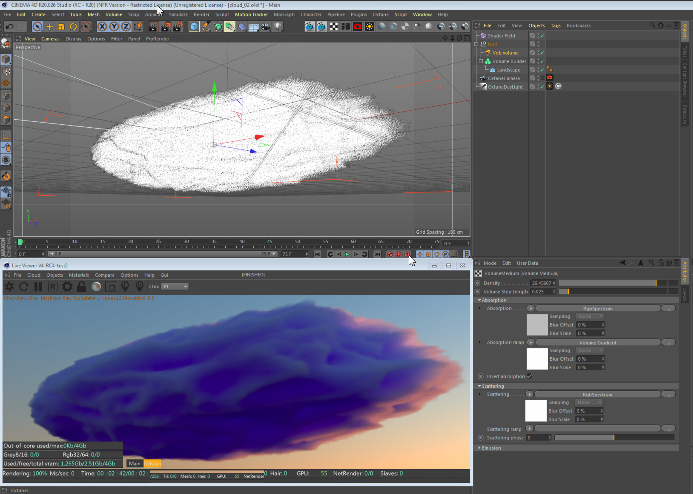

I'll piggy back on this thread as I can help a little, but have a question.
To export from c4d you just select the Volume Builder Object and go to c4d:file:export:Volume
But here is the issue I'm having. I can bring the Volume back in but Octane is getting confused and won't bring in a VDB sequence.
Here is what I have. This part works great.
https://www.dropbox.com/s/txal8eu3rs2gu ... 2.jpg?dl=0
But when I try to enter the digits -- in this example 10 for frame count, and the start and end frames (0 and 9)....it loses connection to the file and displays nothing.
Edit: OK...I see. The "digits" field is where I'm supposed to enter the numbering scheme. If it's 001,002...then 3 digits.
