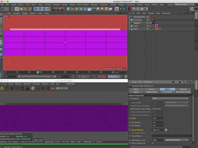

Hi, explain to me how to combine the view from the C4D viewport and octane LV at the Front projection

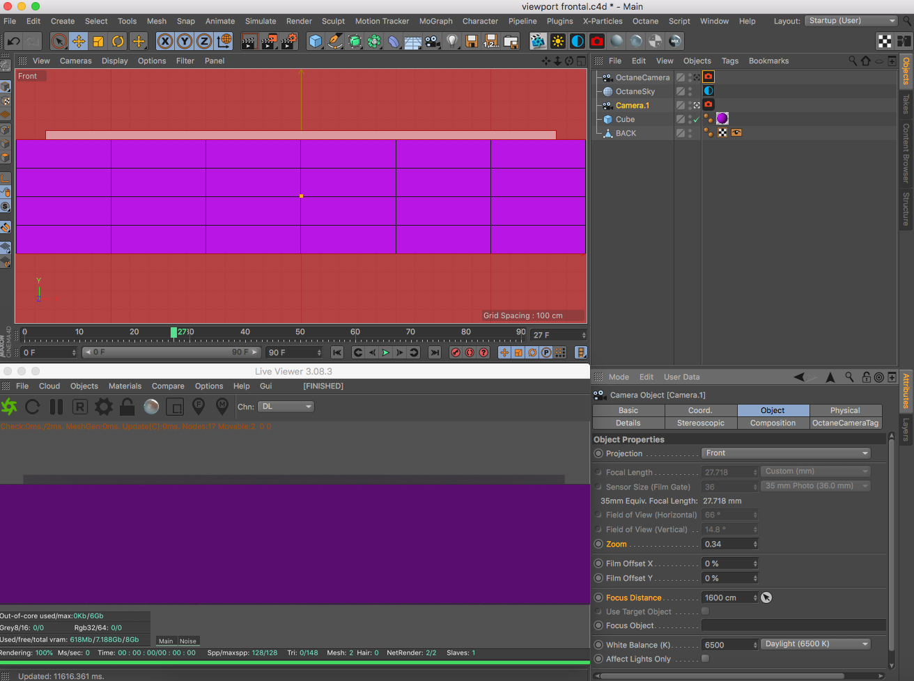

Hi VVG,
since you have changed the zoom factor to 0.34, you need to set the Focus Distance to 1600 in the attribute of the camera, to get the same result: ciao Beppe

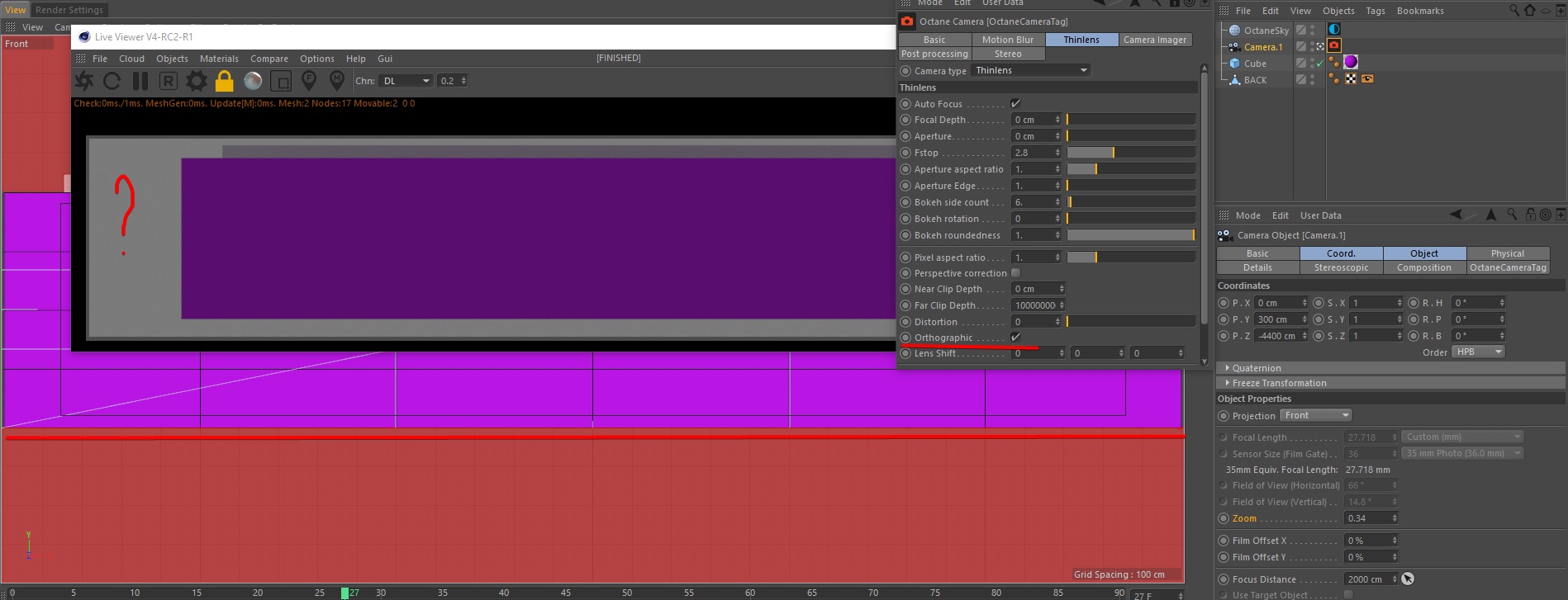

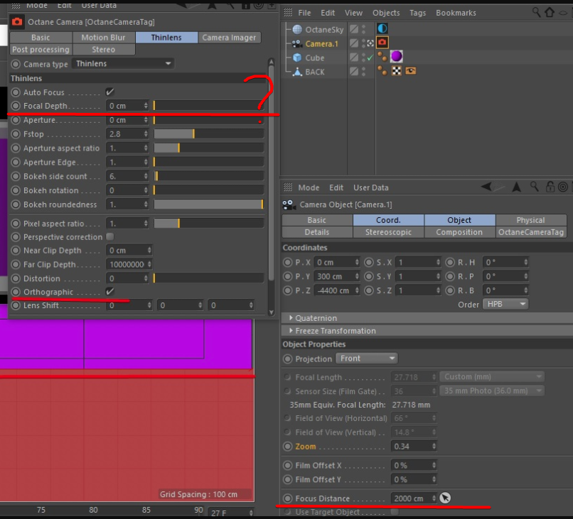

Hi, Beppebepeg4d wrote:Hi VVG,
i thank you for investigation, but why Focus Distance does it matter for octane?
or is it a bug?
