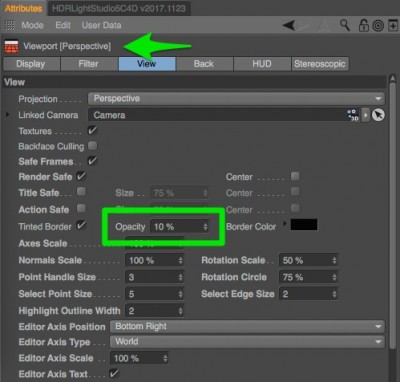

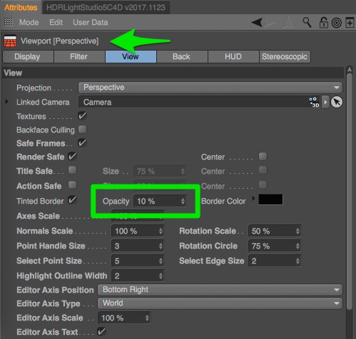

Reading your frustration at not knowing your viewport size already, this sounds like a really bad idea for you. If it's off, you'll have no idea where your frame is.
Nevertheless, you can turn them off, by setting your viewport > view tinted border opacity to 0%.
I'd suggest starting at 10% so you still see the lines, but not the dark shading.

I always have tinted borders set to 80% in my perspective view, but at the sides of the window. My Octane Live Viewer tinted borders are top and bottom and seem to have nothing to do with the render size.
