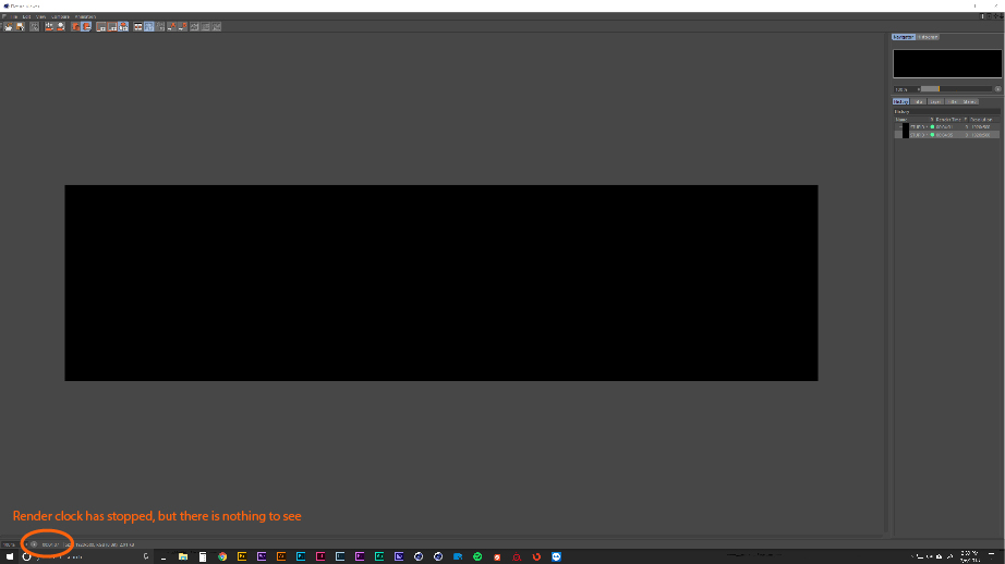

My problem is that I have a scene that won't render- it prepares for 10 seconds, analyzes frame for 10 seconds, creates geometry for 10 seconds, and then for the remaining 217 seconds it just says "updating." It eventually stops as if it's done rendering and I'm left with a black screen. This simple scene is made up of 2 cloners creating two 4x4x4 stacks of 5 gallon buckets. The project is going to require labels to be on these buckets of course, but in an attempt to troubleshoot and find out what exactly is causing the scene not to render I have removed all textures, HDRI's, etc. Even with nothing but geometry and a white sky texture this damn scene will not render to the PV. I have spent most of the day restarting my computer and force-quitting C4D, just trying to get these pails to render and I'm at my wits end! My rig is pretty suped-up with 64gigs of RAM and twin 1070s, so I really don't think it's a matter of the scene being too heavy; it's something else.

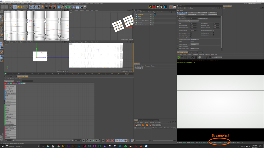

Another odd thing is that when rendering the scene to the LV it takes a really long time and displays erroneous information in the bar at the bottom of the LV during the render. For instance, I am just trying to render 128 samples, yet during the render the picture viewer appears frozen for several seconds at 1728/5000 samples. I dont understand where it's getting that number. When it finally finishes rendering the bar below says it's merely 128 samples and took only 1 second to render while it actually took about a minute to render.

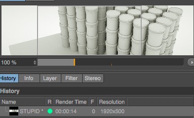

This is what I'm trying to render to the PV

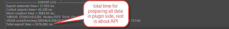

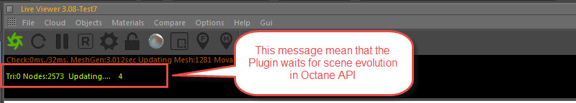

All correct, scene is highly unoptimised. Alse check two pictures for explanation.
