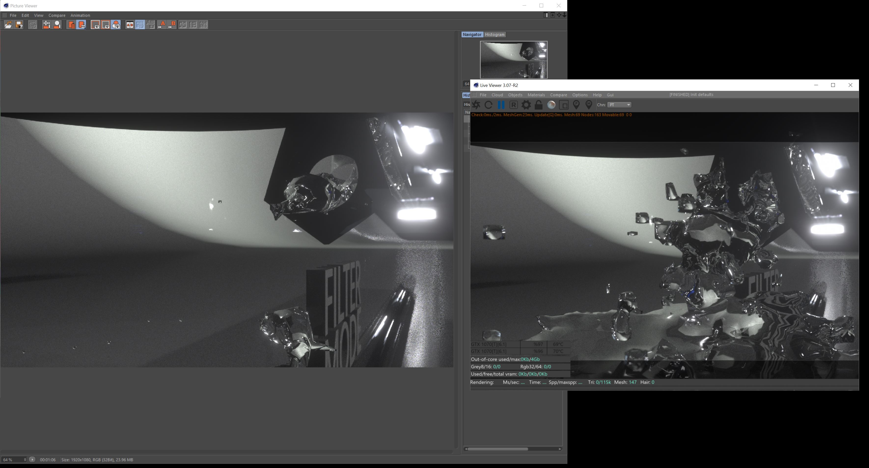

3. Also, the mesh created in the picture viewer and the one in the live viewer are not even close to the same. The one in the live viewer is accurate, the picture viewer is like it is getting held back. I'll include a screenshot.

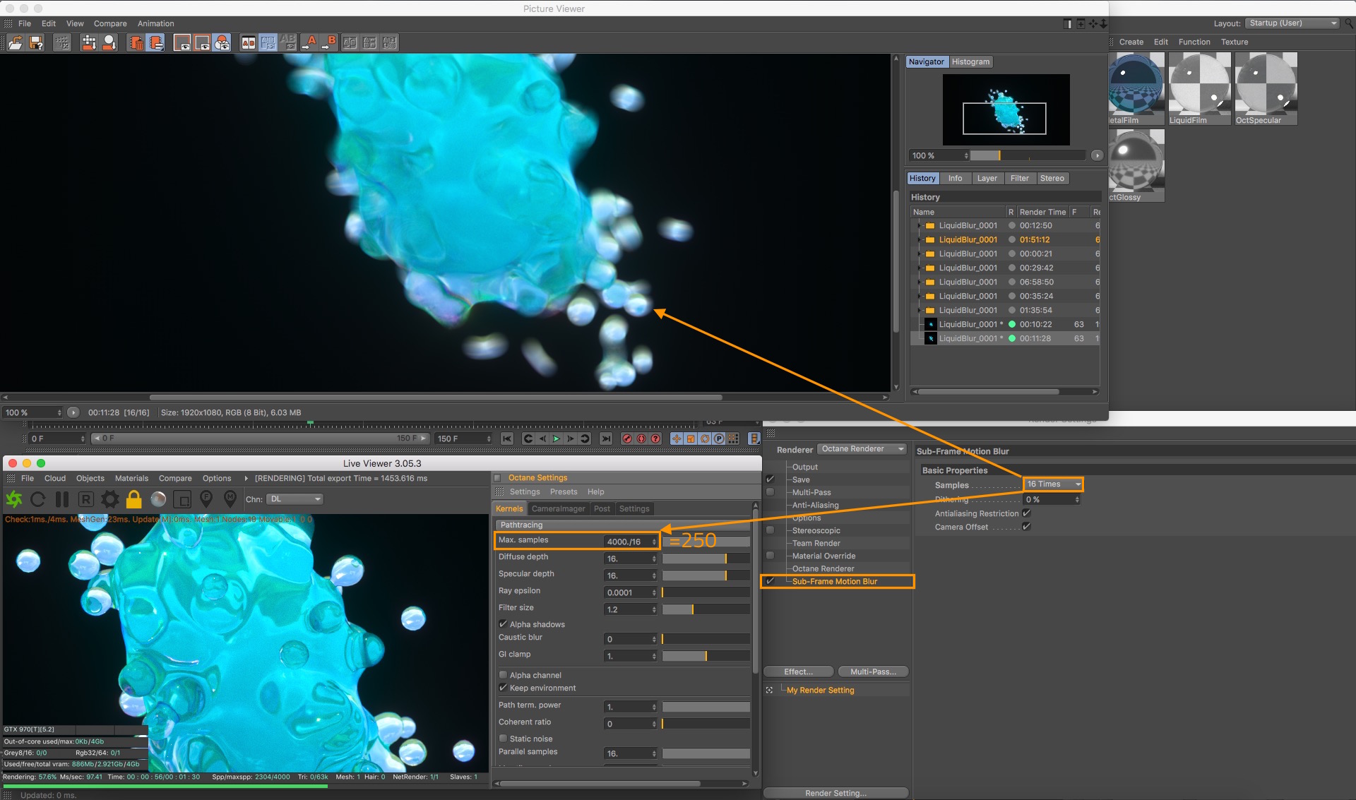

Hi Thomas,
if the number of vertex is changing during animation, you can use the sub frame trick:
Since the max sampling is divided by the number of passes, the rendering time is almost the same.
ciao beppe
