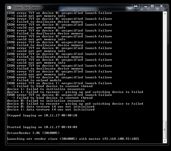

As you can see, a slave crashed on the 5th frame, and the frame paused at 99.97% for 14 hours. When the slave was restarted everything ran fine again.
Slave failed 5 frames in. When restarted it worked fine and completed the job
In this case, the error was CUDA 719, but this is not consistent - it sometimes be an error of "not receiving all information for a frame", or sometimes simply say the "slave crashed or was stopped (CTRL-C)"

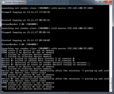

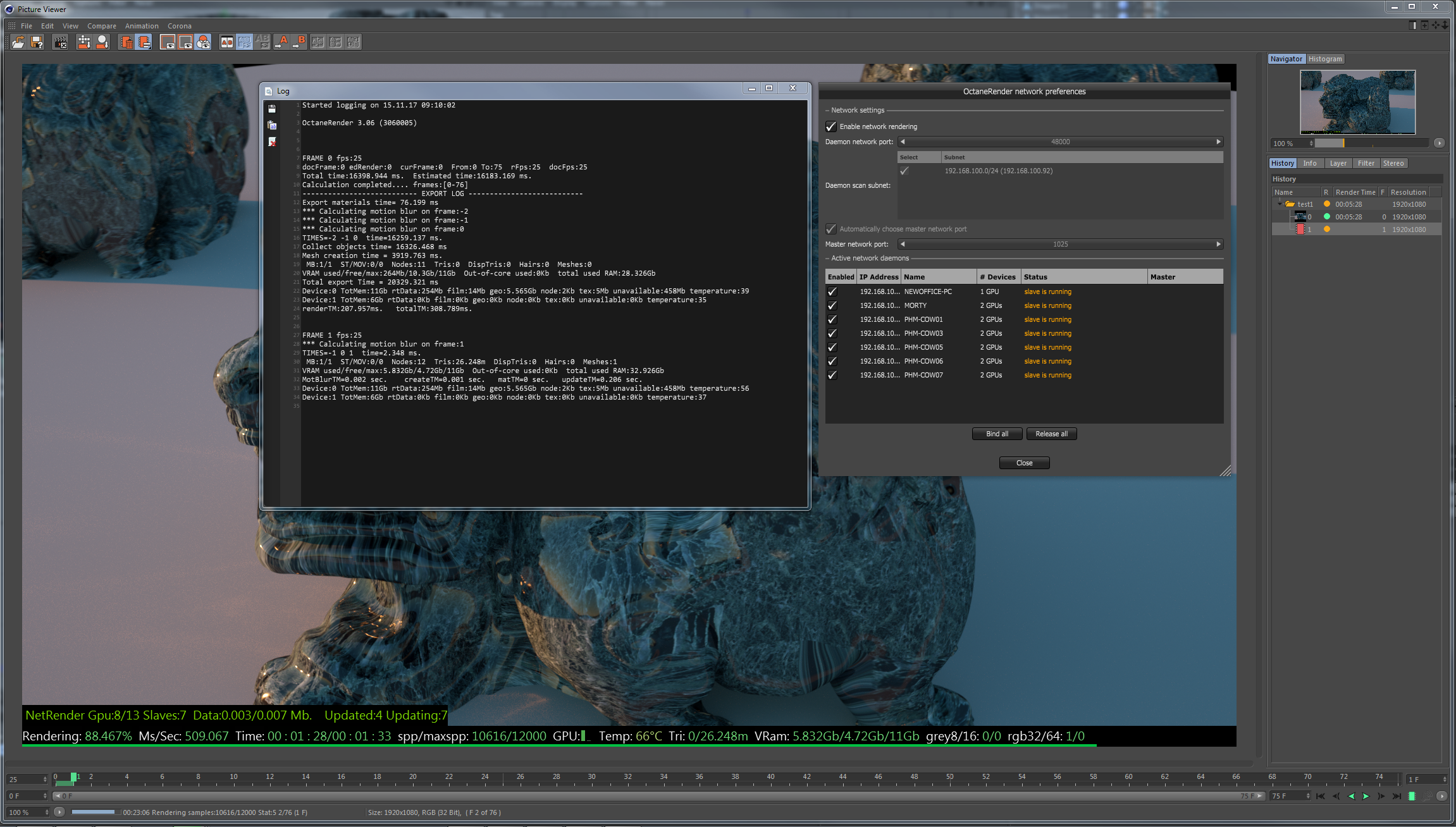

I've managed to make a scene that uses just a bit too much memory for the 6gb cards and this does reproduce the error - but not consistently.
Most of the time the slaves fail and the render continues, but sometimes - like in this screenshot - the render gets stuck.
You can see that:
The slaves don't show as failed (three of them did because of lack of memory)
Nothing shows in the log
The render is stuck - it's been 5 seconds from finishing the frame for over 15 minutes.

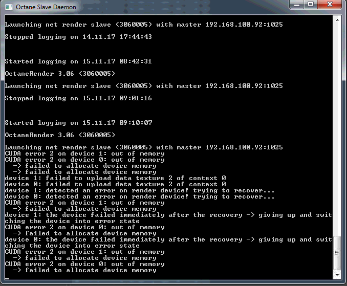

On the three slaves that failed, this is the error:
While I have managed to force this to happen, as mentioned previously it's not the same error every time. It doesn't seem to be related to any single issue, but occasionally the slave that crashes doesn't seem to talk to the machine in charge of rendering, which waits indefinitely for a result that's not coming.
What would be great is if there could be a time-out set on the master, so if it receives no result in a set amount of time - 2 minutes for example - it excludes the slave and carries on, or even a command-line instruction on the slave daemon to quit if it encounters an error. Is that possible?
