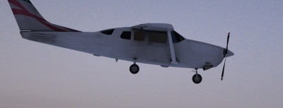

Before projection
Before projection

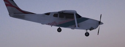

Projection added
Projection added
Breaks upon rotation

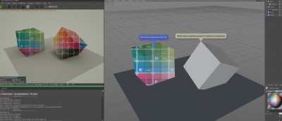

Screenshot to show setup

As i can see that's not about rotating objects. It's about having some parent to CAMERA. In this case, rotation calculation of camera matrix gone wrong. I've fixed right now.
As a workaround you can use camera without parent or use c4d's camera mapping from texture tag. But it has to be used without "selection".
Posts: 16068
Location: Türkiye
Here's a sample scene with two methods. But it will work fine on fixed version.
