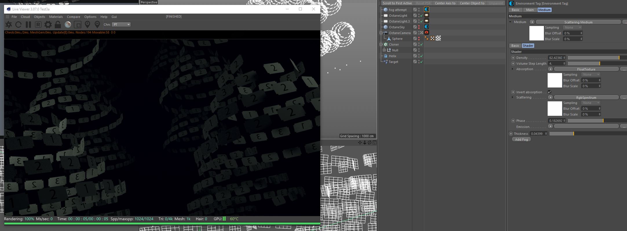

Hi, for some reason fog medium through sky tag doesnt work. I end up using the old workflow with sphere/inverted normals all the time. I follow all tuts step by step and same settings dont work here.
Fog medium is like affecting everything uniformly.
How to solve this? im on r18, beta version.
ty
c4d file: https://www.dropbox.com/s/8f29jge7j699l ... m.c4d?dl=0
nothing works here no matter how much i fiddle with settings

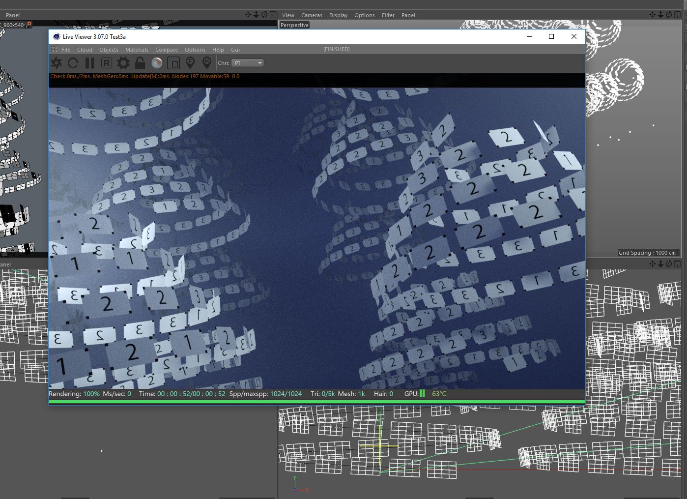

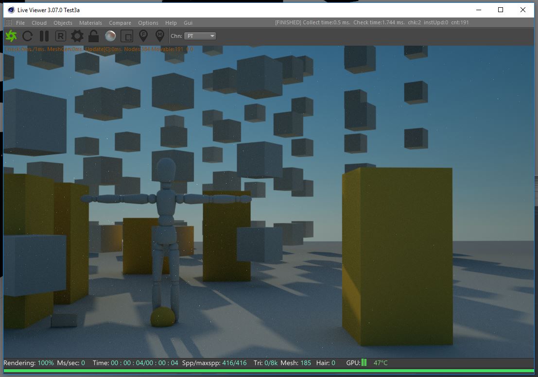

works as expected
works as expected

Some help here plz? thanks
As u see sample scene has same issue. What might be wrong?

Hi guys,
unfortunately there is a bug in 3.07 test 3 SDK with medium environment, that has been already fixed in the general SDK.
So the next version of 3.07 plugin will not be more affected by the issue.
You need to go back to v3.06.2 for now sorry.
Happy Rendering,
ciao beppe

Thank u. i been hitting my head on the wall :)
