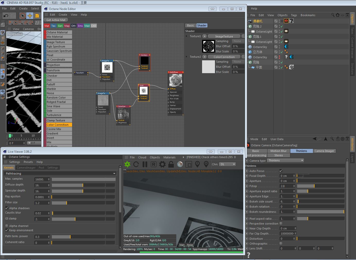

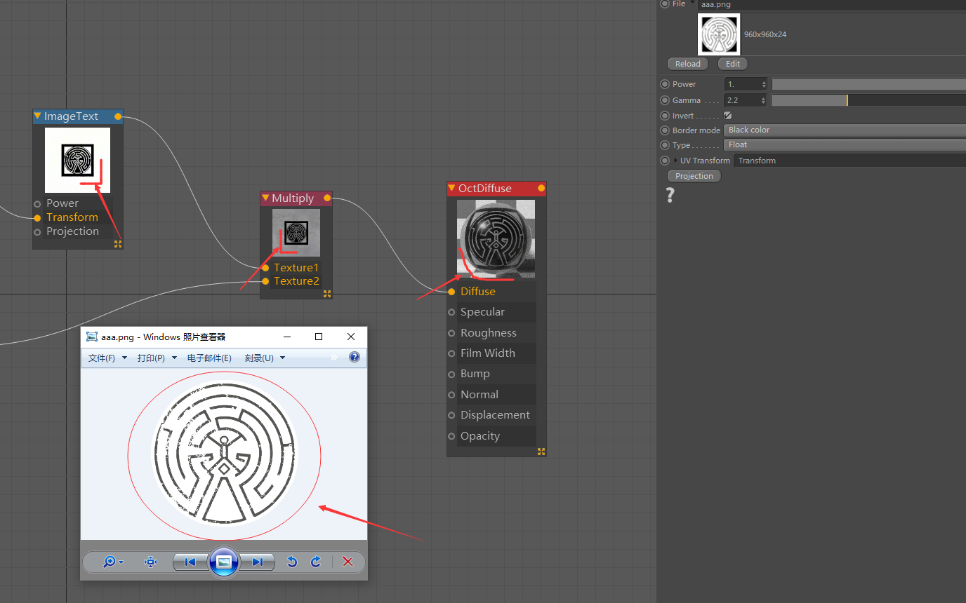

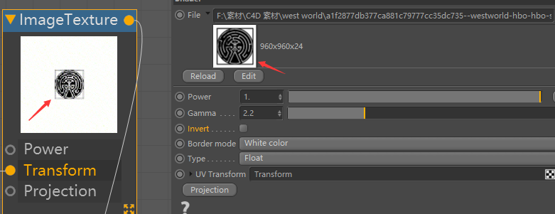

PNG image appeared strange black edge, leading me in the production of materials can not be used normally, is there a problem with my setup? Help me!

sorry, the issue is not totally clear to me, do you mind to share a simple example scene with the material and the png texture that is giving you the issue?

do you mean something like this?
test1_b.7z
(121.53 KiB) Downloaded 169 times
If yes, you need an Add node instead of a Multiply, with black images.
