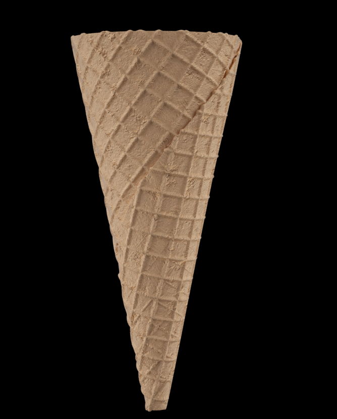

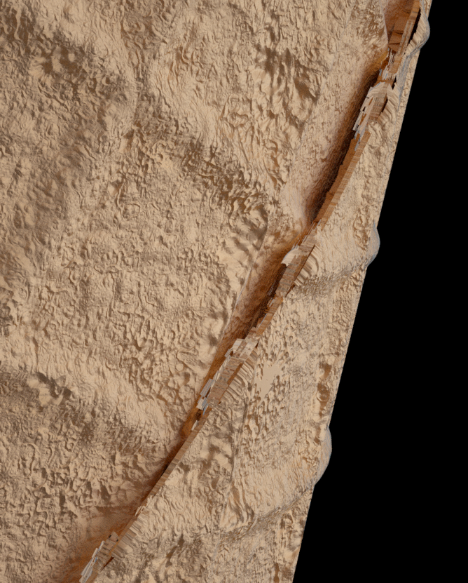

I'm trying to make an ice cream cone using displacements ( with C4D's "tiles" node ). I've made the UV and everything, the only problem is that the displacement tears the edges of the cone, making it very noticeable. Especially in my case which I'm trying to achieve realistic results.
I've read here: viewtopic.php?f=30&t=61685&p=315564&hil ... nt#p315564 that I should turn off the angle limit on phong tag, while that DOES make some changes, it doesn't fix it.
I've tried anything that I thought was relatable and failed. I've even tried crazy stuff like using a falloff node to only have displacement on the center of the cone and not the edges, but that doesn't work and I'm not good with nodes at all.

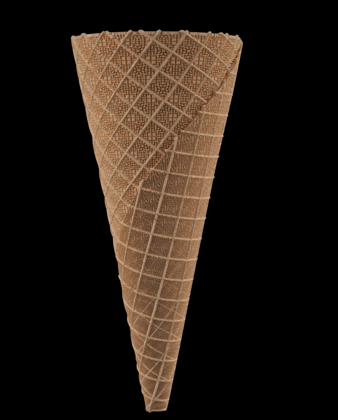

I found a way around it. Nothing on these forums or the whole internet helped me, in fact, it seems like a serious problem that many people have and the devs can't fix it!
Anyways, I got around it by creating a Displacer modifier ( and making it a child of the cone ) and went in " Shading " tab, changing " Channel " to " Displacement ",
created a C4D material, put the displacement ( in my case, Tiles ) in the displacement part of the material, and added the material to the MODIFIER.
Then dragged and dropped the material's tag in the " Texture Tag " part of the modifier.
For this to work, the object HAS to be subdivided so the displacer can give accurate results.
I then tweaked the options in " Object " tab until it gave close results, but it started to make some weird results. ( attached. )
I changed " Type " in " Object " tab from Intensity (Centered) to Intensity. And it was fixed! Exactly same results, but with the edges fixed.
This would change depending on the project, of course. It worked perfectly for me.
