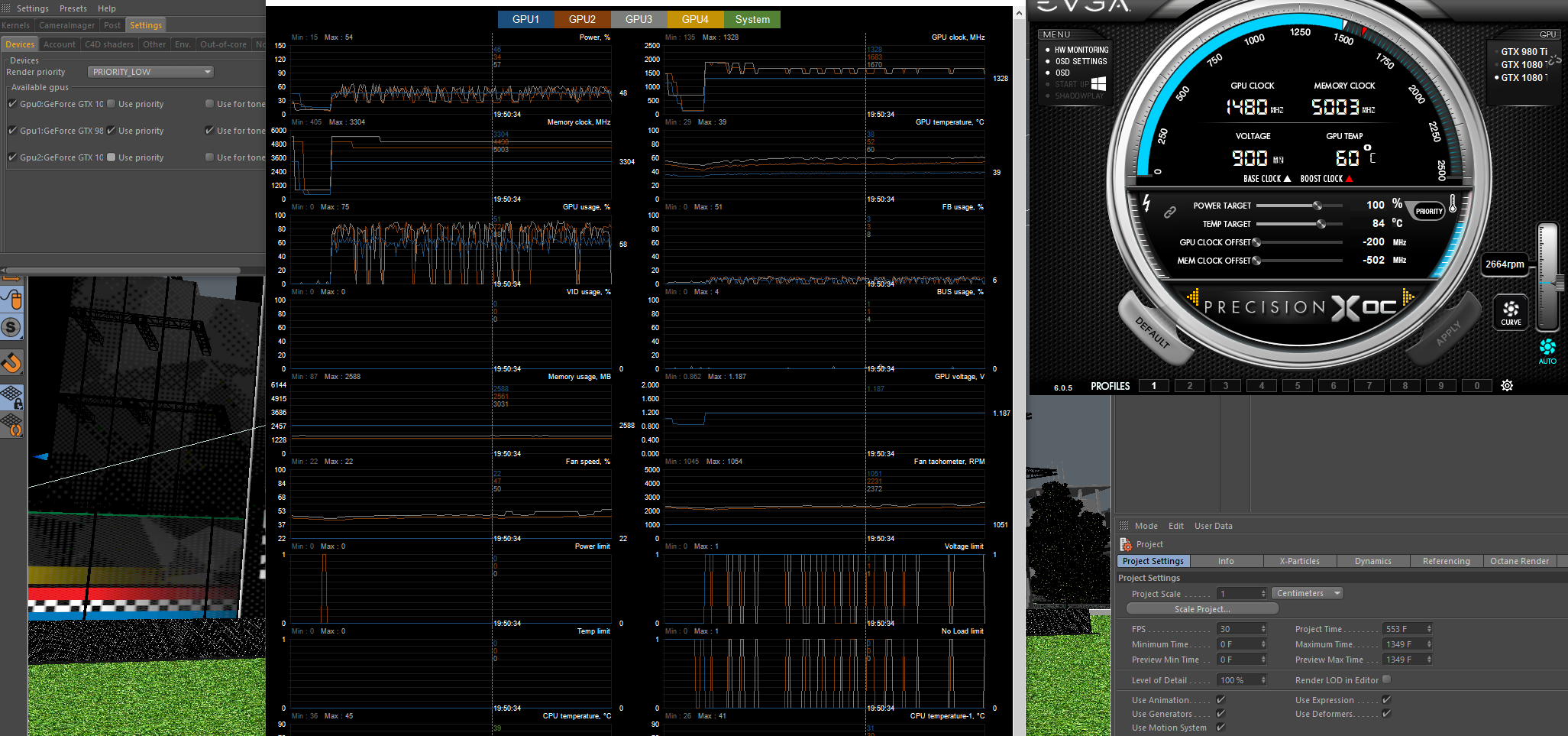

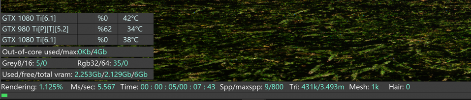

Thanks for the reply. I went ahead and updated to the latest Octane C4D build V3.06 this morning and am still receiving the Render Error.
Here's a list of more solutions I've tried to resolve the issue:
-I have gone ahead and done further testing today, including the installation of the V3.06 version you linked. The problem still remains. I have V3.06 of the standalone version installer/ installed on my machine, and also tried using the standalone V3.06 zip version.
-Initially I had a hunch that Octane wasn’t liking the instances or a particular plugin (Forester) in my scene. I went ahead and removed all the assets using the plugin and removed all instancing so that just the object remain. Doing both had no effect and I still am experiencing the Render Error and crashing. I have also gone ahead and double checked all the textures and made sure they have the proper file locations, imagetexture tag, etc. None of these has fixed the issue after some further testing.
-I went ahead and tested as per your suggestion on individual cards, the scene still crashes even with different variations of 1 card enabled and the other 2 off.
-I did a clean install of my graphics drivers with the most up to date Nvidia driver, 382.05. The problem still remains.

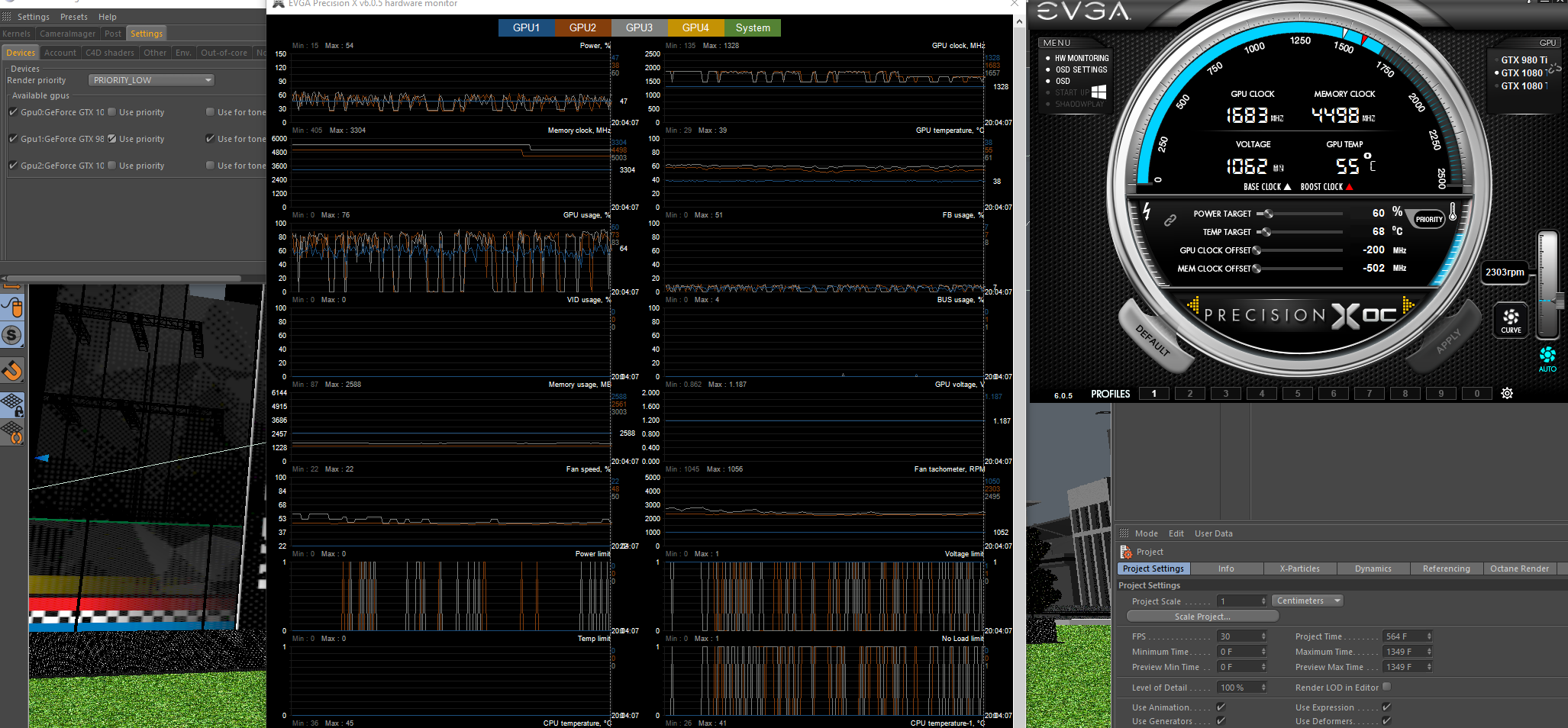

Also not sure if it’s related, but in some cases the scene does render a frame in the Octane Viewer without any problems at all (false hope). However upon changing the camera angle or hitting render, it crashes. Haven’t been able to get it to render past a single frame. I also notice when it is rendering that even when amidst rendering, my GPUs will not remain in full use, and jump between 0% and 50-70%. I’ve attached further logs and screen shots as of the C4D Octane build downloaded this morning as well as what happens after the render crash occurs. I’ve also noticed it randomly will completely take one of my GPUs offline to the point where a PC restart is necessary unless it crashes my computer altogether.
Additionally, every few times it crashes I will get a blue screen windows crash with a DPC_WATCHDOG_VIOLATION error. I've gone ahead and done clean installs of all the associated drivers and system scans for issues with the registry, everything is now fresh and there are no system errors, however I'm still receiving the errors. The last thing I haven't done is reset the PC/ reinstalled Windows which could be a last resort measure.
Let me know if there's anything else you can think of that may be causing the problem. I will continue to tinker on my end. Thank you very much for your help and assistance in advance!
-Kyle

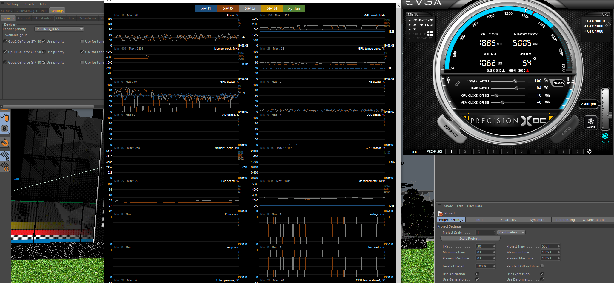

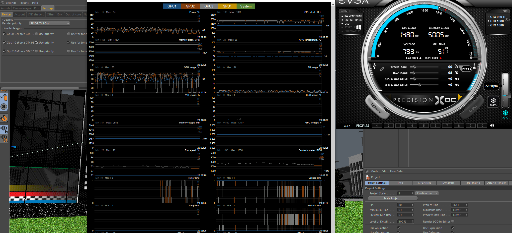

Hey Aoktar,aoktar wrote:Your some gpus may have defect. Seeing corrupted pixels and even some bluescreen is giving this idea. Can you try with lowering the gpu speed/frequencies. Also another step is to remove some gpus and try again.

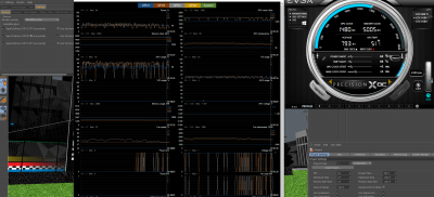

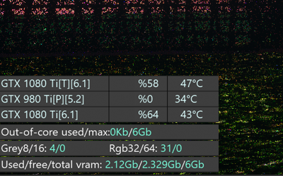

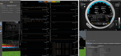

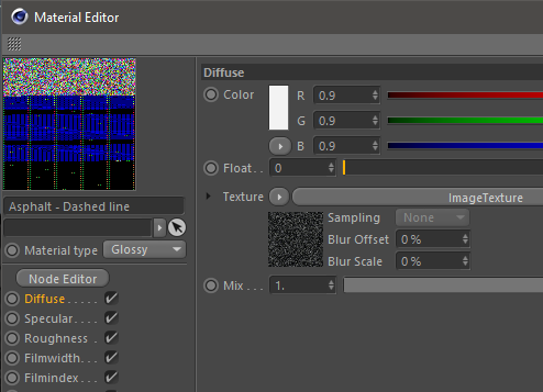

Some more info/ updates for you:
-I have updated my BIOS and reset my CMOS. Problem persisted.
-I rolled back my Nvidia driver to the previous working version, problem persisted.
-*I copied all the scene data to a new scene and saved it differently. I am no longer receiving Render Errors! However, I don't believe the problem is solved as of yet as there is some wierd stuff going on with my 1080ti cards as you'll note by the graphs below. I also tried underclocking the cards and noted some difference in behavior by setting the card priorities all to "use priority"
I am now on version V3.06 stable for both the standalone and C4D Plugin, in Cinema 4D R18.
Let me know your thoughts based on the images below, thank you!
Sincerely,
Kyle
