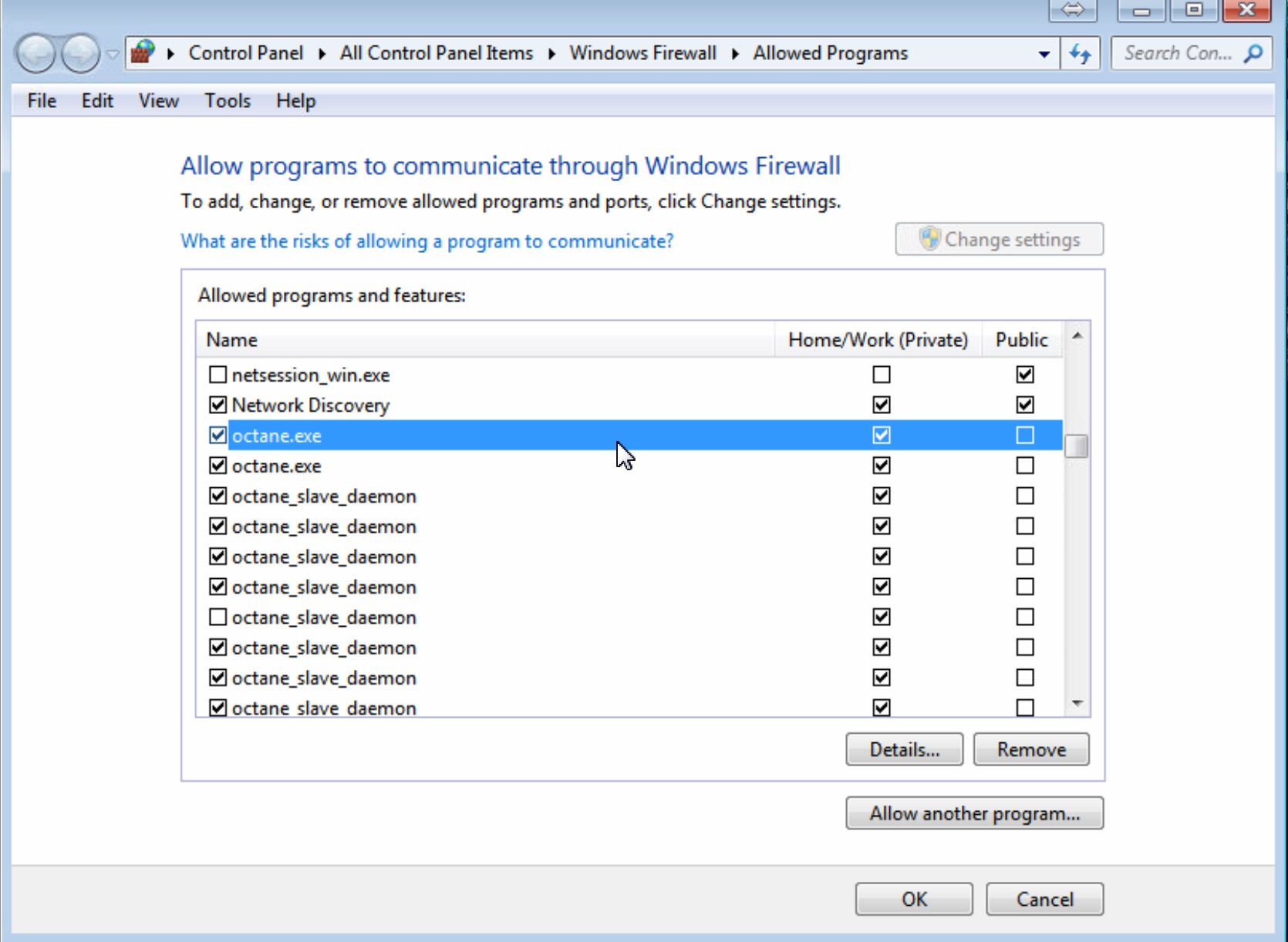

So, I'm using the same versions of Octane (both standalone and plugin) as well as same versions of Cinema 4d. I'm trying to setup Octane network rendering, and it works fine if I turn off the Windows Firewall completely. If I turn on Windows firewall, it doesn't. I tried to allow port 48000 (default port) in Windows Firewall by going to Advanced Settings > New Rule > Port, but after that I still didn't see my slave listed.

have you tried to enable daemon and Standalone in the "Allow programs to communicate through Windows Firewall" window?

Thanks for the reply. I checked and I do have exceptions in place for all of Octane's apps. This is driving me nuts.

Do you also have exceptions for the C4D application? When running as a plugin Octane uses the exceptions applied to the host application.
