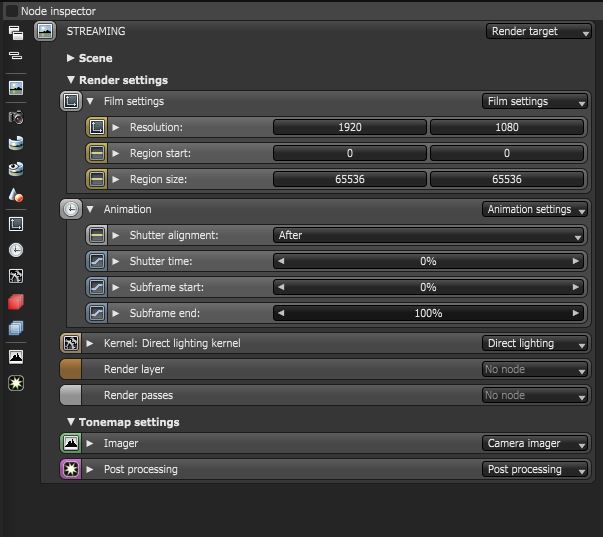

The first way: Once you export your scene to the standalone Octane as you did with the orbx file, click on the bottom most node. Then click the second button down under the node inspector to collapse everything, then rexpand the "render settings" twirl down. There you will have a film setting and you can change your resolution. My .orbx files were almost 20gigs but they worked.

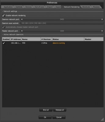

I have setup C4D on a Windows 10 based system that has Quadro GPU's. The Windows "master" computer is running C4D R18 with latest update, Octane C4D plugin 3.06 and standalone 3.06. Next I have a GPU server with 8 GPU's that is running Ubuntu 16.04 LTS and also Octane standalone 3.06. I have run the daemon script in Linux and it successfully generates the run_octane_daemon.sh
Next I run the run_octane_daemon.sh and everything seems to be working as it should. However, the problem I am having now is that no matter what I try I can't see the render slave on the master. It simply does not show up in either C4D or octane standalone on the master. As you can see in the screenshot below, it is all running correctly except no slave is detected by the master.
https://www.screencast.com/t/YdEooXxqMxcT
I have spent hours checking the network settings. I made sure I can ping to the private IP of both the Windows master and the Linux slave and vice versa. I also opened up firewall settings to make sure that nothing is blocked. There is no virus software running in this testing environment. This is all running inside of an HPC grade data center with 10Gbps networking between the machines.
I am really stuck here because I need to start rendering this animation, but the only way to get it done is if I can use all 20 GPU's via netrender.
Help is very much appreciated! ;-)

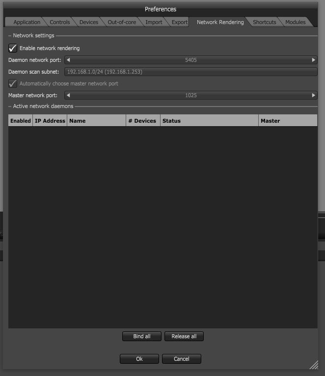

Looking at the picture, my only thought is—you don't run the standalone program on the remote render system, just the daemon. My remote standlone doesn't show anything on the network tab either. That's not how you check.
To check networking, you open the standalone on your main system after you start the daemon on the remote and see if the 8 gpus show up there.
Once it's all setup, you don't even run the standalone on the main system. (unless you are using the orbx file technique.) You simply run the commandline at the desktop as I mentioned earlier and your scene will begin to render. (remember to test it with a few frames, or you can kill the commandline.exe in the taskmanager as well.)
BCres
Two shots show my local machine and remote. Notice how the remote doesn't show any network renderers.

I really hope you can help me figure out why the slave is not showing up at all in the master octanerender network preferences GUI. As you can see from this screenshot the slave does not show up at all on the master. https://www.screencast.com/t/wu4eqfmte3hI
I have made sure that there is no issue with any firewall blocking anything. Currently all traffic is open between the two computers, they are on the same subnet, same 10Gbps LAN network. I also tested and I can ping both machines from one another to their local IP's.
I am really not sure what else to try.
