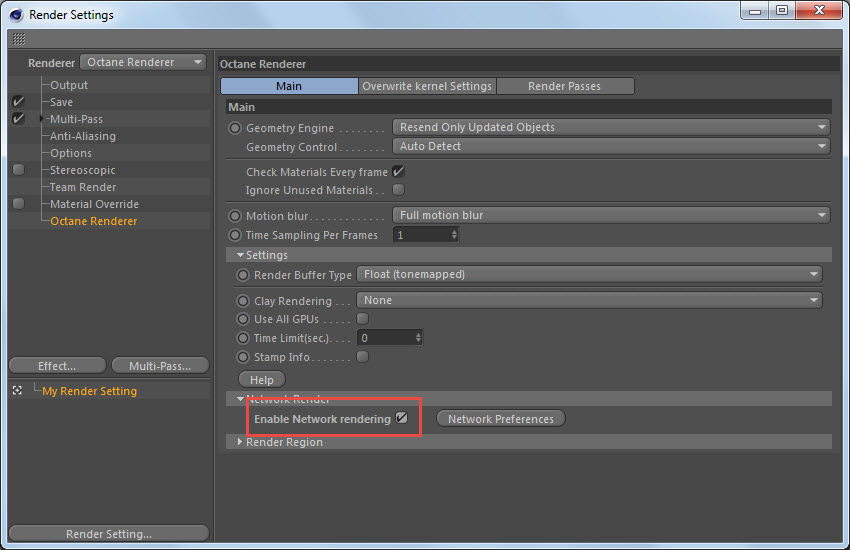

Correct way to select "enable Network Rendering" in Octane Render Settings and install and select slave in the another machine for your case. What did you tried and couldn't made? Did you tried this?

Yes, that's what I've been saying. It's ticked. Slaves are running fine and showing. When I use the LV I can see my local GPU plus 2 of 2 gpus in 1 slave. The network rendering is all working fine.
