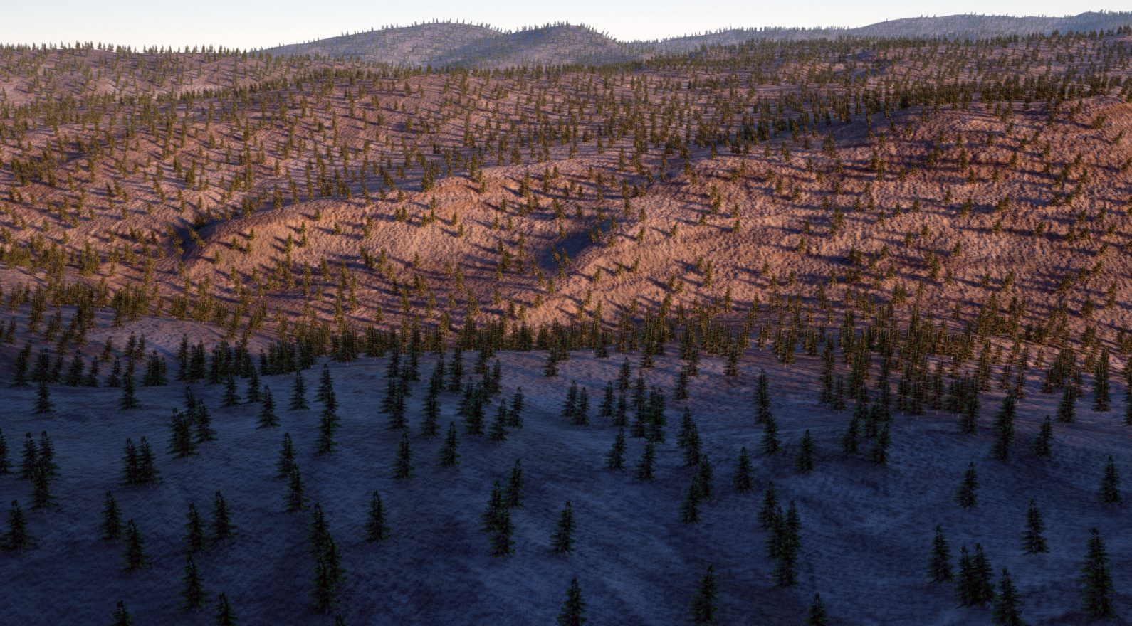

Here is an example of a scene I worked on for a bit. Nothing special, just messing around. However, I am wondering if anyone here knows how to scatter objects along slopes of other objects and also, how to align objects to point straight up.
As you can see in the image, many of the trees are placed in unusual ways along the slopes of the terrain.
By the way, there are about 400,000 trees on this object, and Octane handled it pretty well. Once I use 2 different tree objects though, C4D crashes.
In any case, what I mean by trees being placed on slopes, I just mean constraining them to a certain degree, so they aren't being scattered everywhere on the surface.

To align objects to point straight up change "Normal Align" to 0.
You can control slope scattering changing min/max sliders in "Normal Threshold".
Win10x64Pro || C4D || i7 2600k || 32GB DDR3 || 1x MSI Twin Frozr II 1GB (Display) + 1x EVGA 780Ti 3GB
I could have sworn that was the first thing I tried with no result. This month has been a bit of a confusing mess for me. XDunsergio wrote:To align objects to point straight up change "Normal Align" to 0.
I'll try this. Thank you, unsergio.
