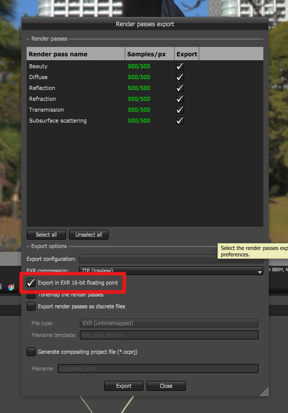

There is an option in the Standalone to export passes to OpenEXR in 16bits floating point. I dont find this option in the Octane passes in Cinema 4D. Does Aoktar forgot to add this option in Cinema 4D or do i need to buy new glasses? :D
I ask this because I'm starting to work with Affinity Photo that does not support well OpenEXR exports without this option. Exports from Standalone work very well with this option.

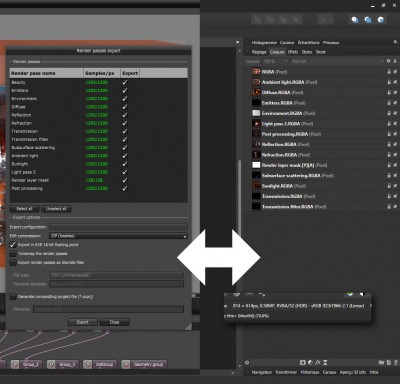

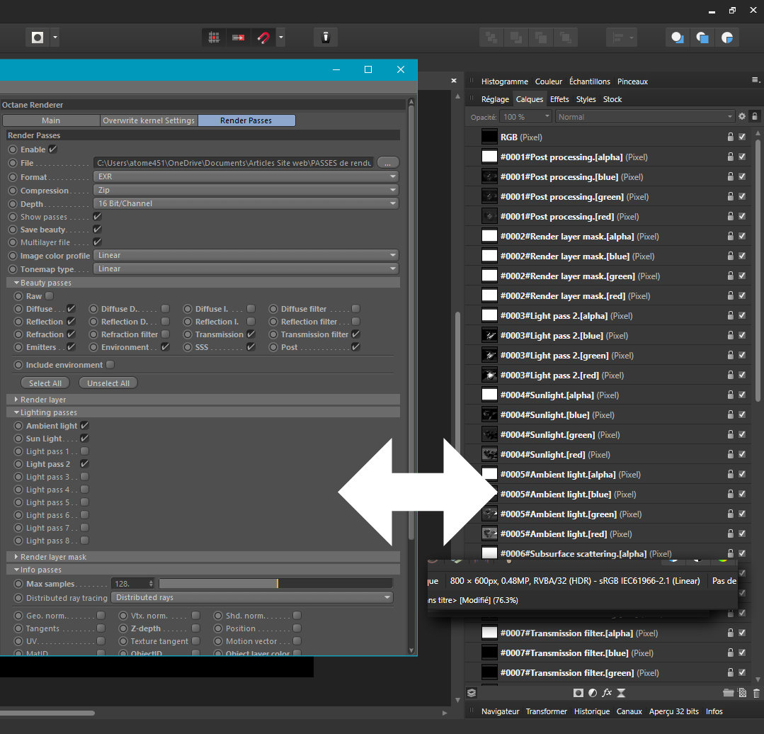

Here screen captures of the results from Cinema 4D and Standalone in layer tab of Affinity Photo. As you can see, the result from Cinema 4D isn't the same.
Well... It's not very important because .psd or .tiff works fine but the files are really heavier.
I hope these informations will be usefull.
From Standalone to Affinity Photo
From Cinema 4D to Affinity Photo
