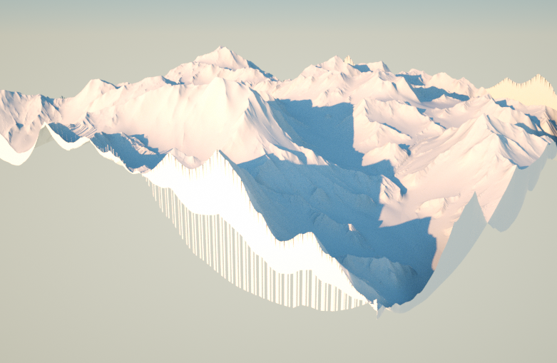

Hello there. Im using bunch of planes one to one with 4k displacement maps from world machine. Nice solution in terms of render time.
Though im getting strange artifacts on the edge of every tile, as on the pic im posting. It ruins the whole idea of building a big terrain out of tiles.
Same issue perstist if i'm converting the scene to standalone. Please help!

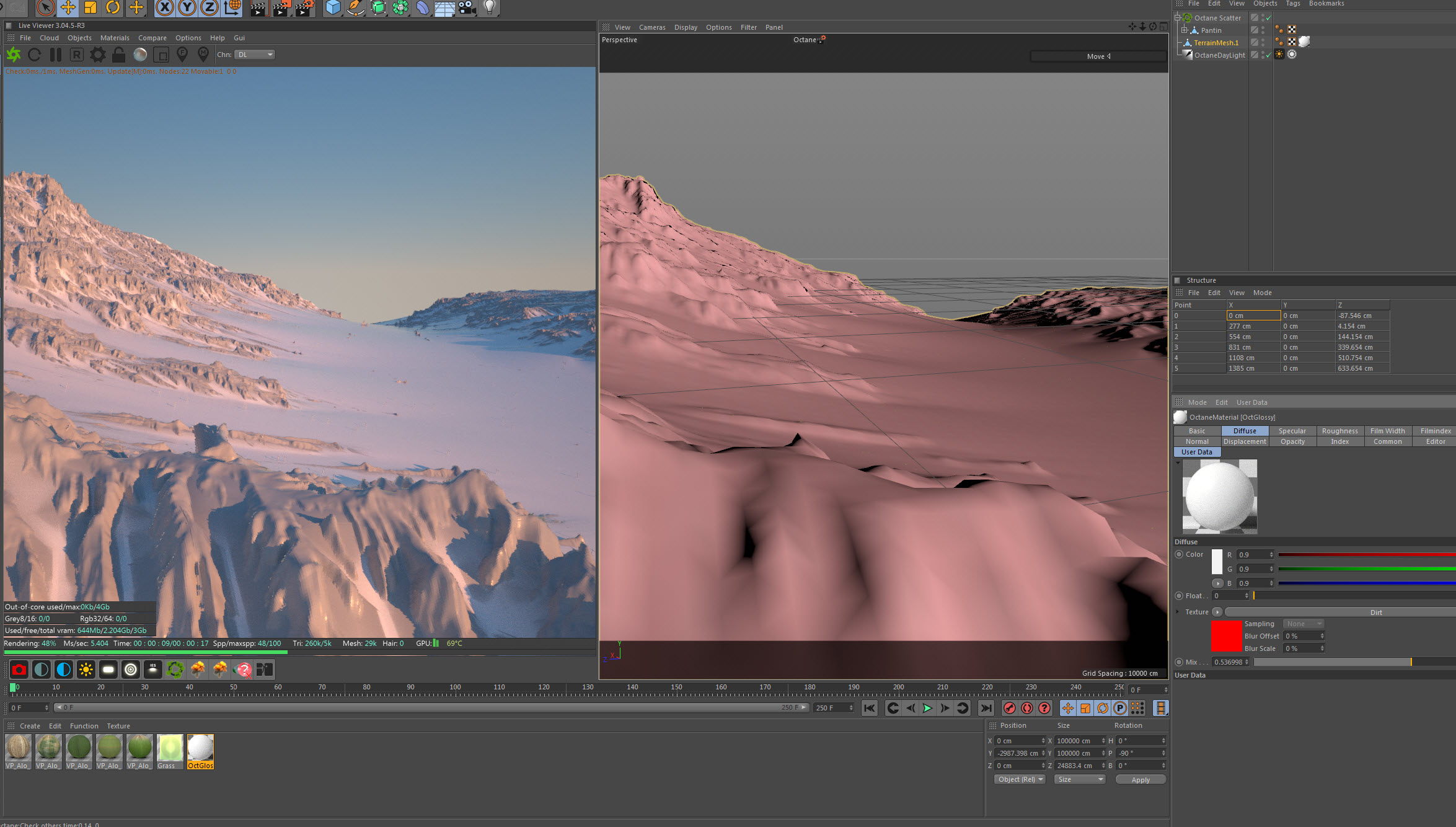

I tried illustrating it in this scene file, https://we.tl/MS7Wm5UXYd the issue with the tiles and the glitching should be clear I hope. Can you please advice how to avoid these glitches on the edges of displacements in general? As shown also, I can get the glitch to go away by cropping the polygon a bit, but that solution is no good for tiles, because it removes the area on the edges from the displacement, from there I finally tried scaling the UV manually (...) but this doesn't seem able to get me to the final goal of seamless tiles of displacement.
